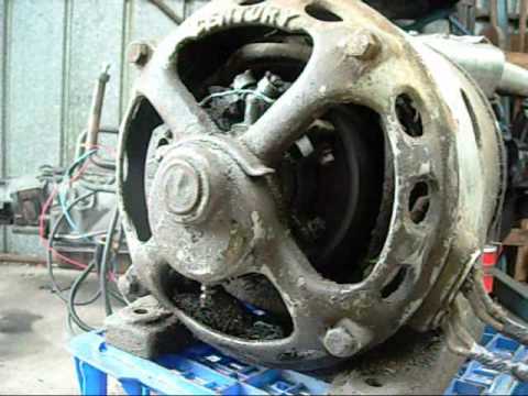

    If it's not a 3 phase motor it won't work. Do you know anything about it? Pictures? Description of what you see?
    If it looks anything like this, keep it as a museum piece. It's called a Repulsion-Induction motor and because they are physically big, people assume they are 3 phase, but they are single phase. They were very common in old farms and machine shops dating back to the turn of the century, but are essentially useless today unless you want to keep making your own wear parts.
    Scale on that picture is a bit misleading, this is a 1HP 230V motor.
