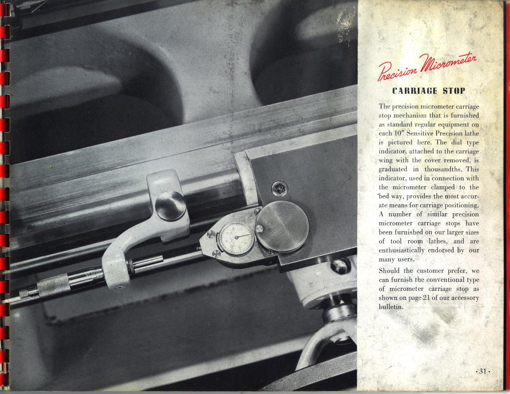

The carriage micrometer stop for a Sundstrand lathe is a different design than the stops used by later machines. I will see if I can find a photo.

I'm pretty sure that doesn't have anything to do with the carriage stop. Here's a shot from the 1939 brochure that has the micrometer attachment:
Thank you. Does anyone have a photo of the dovetail that this would have mounted to? Or know how this mounts to the carriage? Does this mount in the same two offset screw holes the part in my photo use? Or did a small dovetail mount using these holes that the micrometer stop then attach to?
So far as i can tell there is no dovetail mount on that model, not with the early models, anyway. There is a picture in the '39 brochure that shows the end of the saddle and it's clean. Best guess the indicator mounts to the saddle using the big knob on top.
It's possible the brochure shows 2 different lathes and the original mount is using a dovetail but it just doesn't look like it.

The carriage stop is still a mystery to me though. Yours attaches with the dovetail that is screwed onto the carriage. Mine does not have that dovetail block or a screw hole where it could have gone. On one side there are three holes, in a slightly shifted location, top and bottom holes are threaded. The other side of the carriage there are no holes at all. IMG_4863.jpeg

The three holes for the dovetail mount are the same as mine, except the bottom hole is not threaded on mine. The two corner holes are for locating pins.
