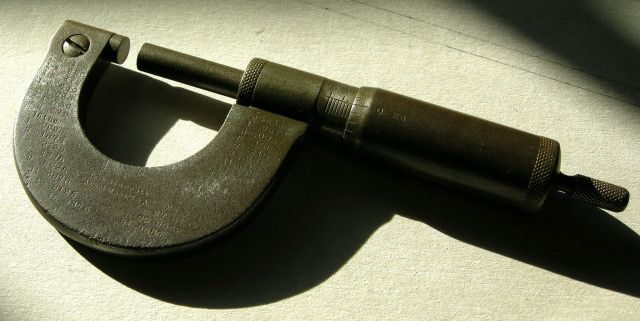

I now have an Elliott Bros 0 - 0.6" micrometer, featured in post #15 here:-
http://www.practicalmachinist.com/vb/antique-machinery-history/english-micrometer-1870s-171345/
It did not have a pitch error needing correction by sloping the fiducial line.
In fact, its accuracy is very good.
There is a zero error, and I didn't bother to correct it, but went straight into checking the calibration, using eight slip gauges over the range. There’s no ratchet, so I tried to apply the same feel each time.
The readings proved to be very consistent. Using a magnifying glass, I estimated the reading to the nearest 0.0001". To my surprise, all the checks showed it to be accurate within 0.0001", i.e. no reading deviated from that expected by more than an estimated tenth of a thou.
This accuracy was especially surprising in view of the zero error. I soon realised that the anomaly was probably explained by the relatively poor state of the anvil and spindle faces. When the two faces were in contact with each other, this gave the anomalous measurement - all the other measurements were taken from the flat surfaces of slip gauges.
In fact, close scrutiny showed wear of the faces, and even slight mushrooming of the spindle end! The micrometer had evidently been much used.
The small diameter of the end of the spindle and anvil, and the apparently low hardness, are definite weak points.
In post #2 above, noting the pitch correction on Rivett’s larger micrometer, the late, lamented Karl Sanger (AntiqueMac) wrote 'So, the esteemed Elliot Bros shop could not make a thread accurately?'. Well, Karl would have been surprised to learn that an esteemed US maker also occasionally sloped the fiducial line to correct for a small pitch error!

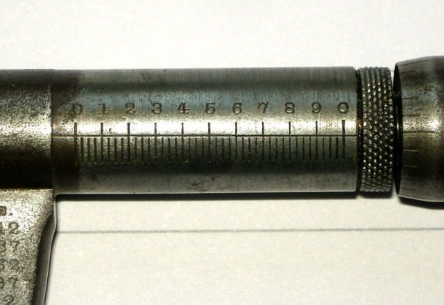

No-one took the bait on pitch error compensation on US micrometers!
However, I’ve been sitting on this for months, but lost heart. Now I’m keen to pursue it. It’s an investigation that anyone with an old micrometer can join in!
I have a suspicion - but no more than that - that it was routine practice in the 19th century (and perhaps beyond) to correct for minor pitch errors by 'sloping' the fiducial line.
This is a Starrett No. 3 micrometer. The fiducial line slopes. The slope is very subtle, but it is definitely present. It is very plain to see when viewing obliquely along the barrel.
I discussed it with ‘Honrick’ some time ago, and he told me that the micrometer was made some time between March 1891 and 1896.
The slope is discrete enough to readily go unnoticed (unlike the slope on Rivett's Elliott mic!) It is there, though. I showed the micrometer to my wife and asked if she could see anything odd about the line, without otherwise prompting her, and she spotted it straight away.
Honrick then checked his early Starretts, and found that on one of the five, the fiducial line is slightly angled.
I’ve checked all my old micrometers, and found sloping lines on just two more, one Starrett and one by Massachusetts Tool Co.
The second Starrett was a surprise, because I assume that it is of a later vintage. It’s a No. 2 model, 0-2" type.
Going back to the one in the photo, it’s the only one with a slope sufficiently large to try measuring.
I mounted the micrometer on a surface plate (holding the frame with a magnetic block), and I set the barrel truly horizontal, using a dial indicator.
I used a vernier height gauge with a knife edge scriber, and set the knife edge level with one end of the fiducial line.
I then moved to the other end of the line and measured the change in height required to get the knife edge level with the line.
The difference was 0.015". I could be a thou or two out, due to the difficulties in getting close to the line and knife edge with a magnifying glass.
Divisions on the thimble are 0.06" apart, so 0.015" equates to a pitch error of just 0.00025" per inch.
I had envisaged a way that the 'slope' could be applied without too much difficulty, but have no idea how it was actually done. It’s basically as already suggested, and in line with Stephen’s ‘rifling machine’ concept.
The engraving machine could be in the form of a basic lathe, with a microscope. The micrometer frame would be set between centres, and clamped to a sort of faceplate. The faceplate has a protruding lug, or a slot, at its rim. The 'carriage' - holding the tool for engraving the fiducial line -would have a bar protruding horizontally from the front. This would engage with the peg or slot on the faceplate. The bar can be set over to a slight angle, set precisely by the operator according to the micrometer's error (see below). Then, as the carriage (and graving tool) is moved towards the faceplate, the faceplate and the micrometer rotate very slightly. Effectively scribing a very fast screw thread! As in rifling.
To determine the amount of angular correction needed, I can think of two ways. First, scribe a very fine horizontal fiducial line on the barrel. Zero the micrometer. Check the error at the 1 inch position with a test block. Use this figure to set the 'correction bar' on the engraving machine.
Alternatively, no fiducial line, just mark a dot at the actual 0 and 1 inch positions. Set the correction bar on the machine to give the helix required to pass through the two points. Too fiddly, I think, for production work.

Hummmmm.... Interesting. I am guessing you are assuming the slight angle of the line on your mic means that the screw is not perfect? A couple things come to mind, if the line were straight with that same screw how far off would it be? If you took a similar vintage mic of the same mic what would happen if you switched screws? Would it fit? Do any of the mics with non straight screws have them angling up(the other direction)?
For some reason in my mind I just can't see Starrett going to that much trouble to make them to this degree of being custom made. But the funny thing is I have no trouble imagining the craftsman at Elliot doing this. I am going to have to look at a bunch of my early mics and see if I can find this on any of them.
Also on the Bregeut mechanism, that is it, just some leather or felt washers and a friction disc or two.....
When it comes to an old company that is still extant and in the same line of business, like Starrett, its easy to forget how much the relative prices and manufacturing techniques have changed over the years. Today we tend to think of a respectable quality 1" micrometer as being easily affordable by pretty much anyone (in the Western world at least) who really wants one. Even at UK minimum wage barely a days pay. When these were made the real world relative price would have been enormously greater. Probably well beyond what the craftsmen making them could aspire to saving up for. More like years of wages rather than days.
In that context individual calibration and scale marking is perfectly reasonable and affordable, an extra craftsman hour compared to just fitting a standard straight line sleeve being neither here nor there in the price context. But the man paying very serious money for the micrometer wants it right, as right as can be. No gauge blocks then so the micrometer would have been the final arbiter. Shades of Maudslays Lord Chancellor.

Rivett,
Yes, the implication is that the screw has a pitch error.
According to my measurements of the slope of the line, the pitch error to be corrected was about 0.00025" per inch.
So, if the line had been straight, with the same screw, then the reading at 1.0 would have been 1.00025".
I approached it from another angle. Suppose that the screw was perfect, but slope was accidental. Improbable, I know. Then the reading at 1.0 would have been 0.99975" if the screw was perfect.
So, I did a calibration check, setting aside the unfairness of doing this on a 120 year old instrument! If the line sloped the way it did in error, we would have expected the 1.0 reading to be a bit under 1 inch. In fact it was 0.4 thou over! So, this does not support an accidental error in the fiducial line.
To address another of your questions, the line on my 0-2 inch Starrett slopes in the opposite direction.
I haven’t got two comparable Starrett micrometers to check the effect of swapping spindles. However, I did have a go at swapping the spindles from the two old Starretts that I have (0 - 1" and 0 -2"). What follows may not be comprehensible!
The 1 - 2" spindle was too tight in the 0 - 1" frame, so no check possible.
The 0 - 1" spindle went nicely into the 1 - 2" frame, but it was too short to reach the anvil, and because of the different spindle lengths, the readings didn't mean anything in absolute terms!
Nevertheless, I checked the reading against 0.2" and 1.0" slip gauges. I found a progressive error of 0.0007" over the range checked (0.8"). Correcting to 1.0 inches, it would have read too high by about 0.0009" at 1 inch. No point trying to over-analyse this, but in short, the fact that the spindle gives different readings in two different frames does support the assumption that there’s a pitch error of several tenths of thous per inch.
Regarding the extra work involved in custom engraving the fiducial line, bear in mind we are talking about the marginal cost, as the frame had in any case to be carefully set up to accurately engrave a 'non-sloping' line. Also, the time and cost of this custom engraving has to be set against the difficulty in making - and testing the accuracy of - the screw, with the possibility of rejection.
