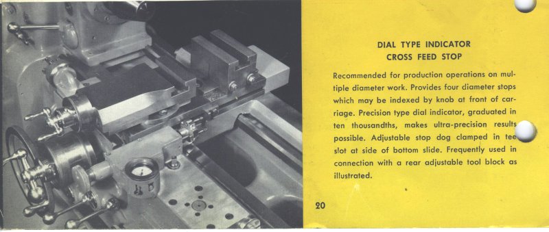

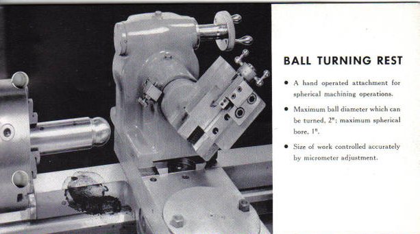

BTW, what is that rear dovetail used for? I'm guessing there are some attachments that mount there?
rke[pler
Diamond
Joined
Feb 19, 2002
Location
Peralta, NM USA
Most commonly a rear toolpost:
Another option, one I've only seen one of:
