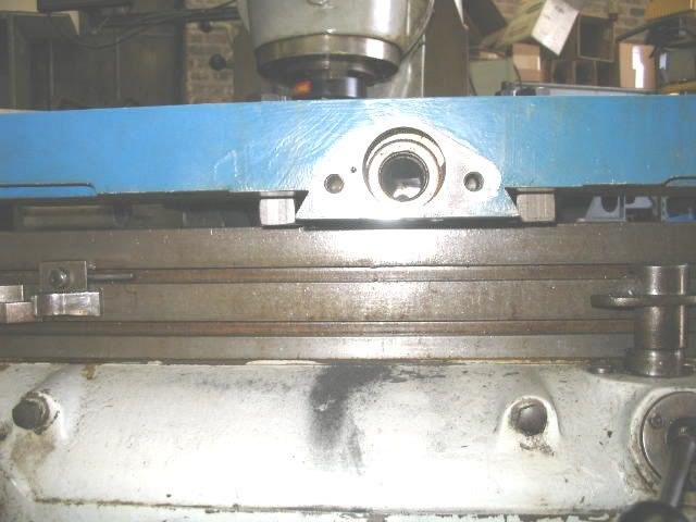

Did a little math today to figure how much to remove from each face before epoxing the Multifil. I'll clean up the sketch and post a picture tomorrow, in order to lessen the confusion of the next paragraph.
The Multifil is .030" thick, I'm allowing .005" for the epoxy, and .006" for scraping stock. For the inside face; .006" stock + .012" wear in face + .007" for amount scraped off bed + .005 filler= .030" Multifil thickness. .005" epoxy + .005" filler= .010" to machine off the face, or .01414" straight down(this is the number I really need due to the way I'm setting it up on the mill). For the outside face I need to remove .021" from the face, or .029694 straight down, using .008" wear factor for the slide face. I'm not figuring any wear factor for the outside face of the V way. For the rear flat slide, I'm not figuring any wear factor on the slide or the way, so a .030" material removal will used.
Since the vertical head is still on the mill, I'll machine the flat slide first, then remove the head, not an easy task, it weighs 300 LBS approx. The V slide will be done with the horizontal spindle. The #4 Cincinnati was chosen because of the 18" wide table, and the carriage is a 25" square.

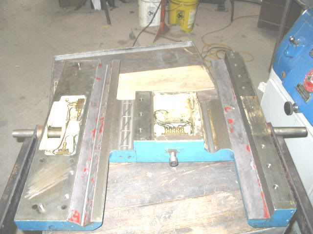

Milling the outside face with a 45* cutter. The inside face has been previously done. I made the extended mandrel so I wouldn't be butting up next to the column. I've got a pair of these cutters that I use in gang set up on an in house job.
The Multifil has been epoxied, now it's watching the epoxy cure. Thankfully it's the end of the day, and this should ready in the AM.
There are 3 sections of weights on each slide, here's the reason. I put lightly greased tubes in each of the oil holes to keep the epoxy out.
The Multifil hasn't been trimmed yet. I use a wood chisel, pushing against the CI base to trim. This is the V slide and you can see the 4 tubes sticking out of the oil holes. The last time I did this, on the CK in 2003, I didn't grease the tubes, and had a bit of trouble getting the tubes out. The grease seems to have done the trick, all the tubes came out easily.
The last trimming operation is done on the mill, cleaning out the V slide's groove. 20 HP mill is bit of overkill, but it was the easiest to set up, including remounting the vertical head, which goes on a whole lot easier than it comes off.
The 3rd spotting cycle. The red medium is being used because it's easier to see on the black Multifil as the scraping progresses. After this was scraped, I did an alignment test with the cross slide, and it's time to start some selective scraping in the V slide. As it is now the CS is about .004" convex.

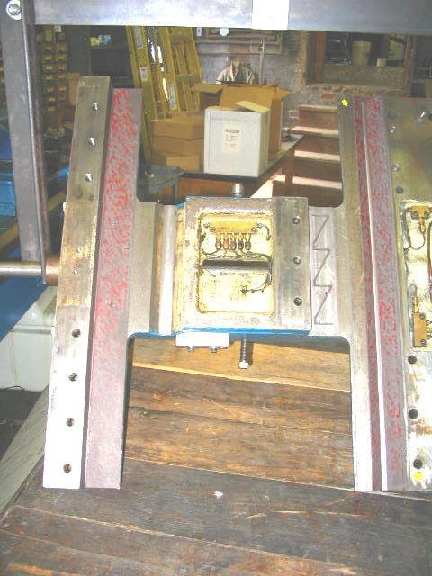

A small progress report.
The picture below is about the 20th spotting, as you can see a lot of progress has been made. I now have a 0-0 reading on the cross slide, actually it's been fluctuating between 0-0 and .0003" concave for the past 8 or so cycles. The balance of the cycles have been to improve the bearing area, and I'm trying to the drop front approx .002" for cross slide parallelism to the bed. I did a couple more cycles after the picture and the bearing area has been further improved, especially on the flat slide. Also consider that the total bearing area of the slides has been increased approx 20%, due to the continous surfaces of the slides. Originally, there was a gap, in the surfaces, under the bridge.
If you look at the V slide, there are 2 yellow dots. These are reference markers I used to tell me which end of that surface got scraped to turn the carriage for the cross slide alignment. It gets very confusing when the carriage gets turned over, remembering which end to scrape. Each of those faces got scraped from the dot to a couple of inches past the bridge.
