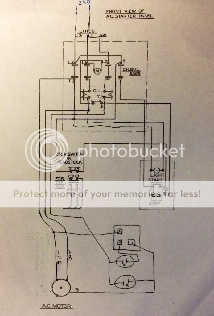

So I'm thinking I can use the original 3-phase starter on my single phase conversion despite the fact the original starter only has two heaters. My logic is if I had a single phase motor, I'd really only need one heater as all the power is going to thru at least one heater and therefore two heaters on a single phase motor is redundant. In my schematic to follow, all the power goes thru relay contact L3 (1,7,12) which does not have a heater. A part of the power for the paralleled field (2,8) goes thru L1 which has a heater and a part of the power goes thru L2 which has a heater for the out of phase field (3). Thus the individual windings (fields) are protected. You will notice I eliminated the transformer as my light bulb in the on switch is rated 240 volts. Guess I'd rather keep similar voltages in the one conduit they go thru. Anyone see a potential error in this thinking?

Please review my original post, and the schematic diagrams attached thereto.
In that post, I intentionally split the run winding across two starter contact sets, with the start winding through the remaining contact set.
Then, in the "return" which is the combination of the two run windings, I place an overload, and the return for the start winding, I place the second overload.
The returns necessarily must be connected before the starter, but after the fusible safety switch.
This, then, will provide a motor controller with overloads in both the run and start windings, and a lock-out/tag-out capability for all.
The Cutler-Hammer starter has overloads which are separate from the contactor, and these may indeed be wired as I have described.
Notice that the headstock's drum switch (same as the ELSR's microswitches) are implementing a "lockout" function.
Namely, the FWD/Off-Brake/REV switch MUST be in the Off-Brake position in order to start the drive system. All 10EEs operate this way.
IOW, the switch sections are N.O. if in FWD or REV and are N.C. if in Off-Brake.
