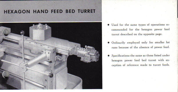

What was the factory turret tailstock like? Do you know of any photos?
If you're asking about the factory hand turret it looks like the one below:
The power turret was very different and it might not mount on a manual (ie not manufacturing) model lathe. I don't know of a Monarch made turret that would mount on a tailstock base, but that doesn't mean that one was not made.

Russ,
Thanks! That's probably what was shipped with my machine (in addition to a normal tailstock). It probably wound up in a scrap heap somewhere. :bawling:
Has anyone ever used one?

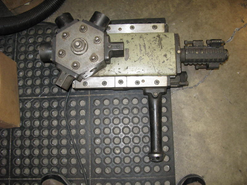

I hesitate to show this, but here it is:
I've mounted it but just to play with it. Unfortunately the work I got it for was needed just before got it home, so I made everything manually. I keep hoping to get some time to clean it up and check it out thoroughly, maybe get some new paint on it. Maybe by next summer...

Out of curiosity, does it have serial number on it?
41354 - so 101 after my 10EE. They might have been littermates.

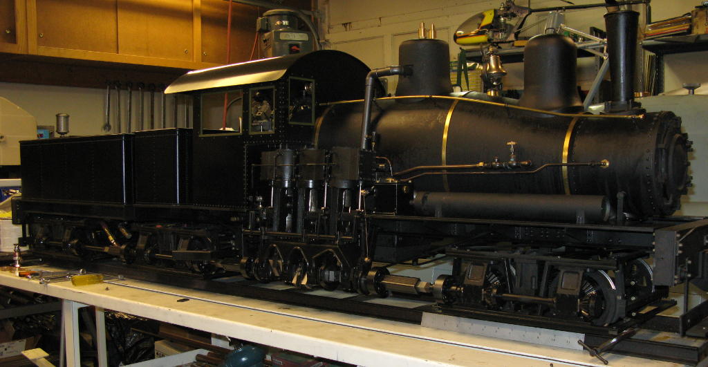

(Actually, I've about finished the Shay:
The grey bar under the front truck is a 12" rule. All the turned parts were done on the 10ee.)

Thanks for the kind words. I've had her out for about 20 miles and everything's holding up pretty well, no major problems. I've moved a few things as a result of experience and messed a few things up, but if you make something once it's just easier the second time. I'm still learning a lot about running a steam loco but it's all fun.
As for finishing - there are some details like plumbing in the whistle (disguised as an air tank), finishing the headlamp and setting up the power for it, some more work in the propane valve area (a pilot operated safety valve and gauging for tank and burner pressure). I've been fighting with the valve for the steam operated brakes, likely make a new one this winter and relocate it when I'm doing the whistle plumbing.
The "final" project will be a steam operated air or water pump - I'm leaning towards air since I have 3 ways of getting water into the boiler right now (tender hand pump, axle pump and an injector) plus it might be interesting to setup some air brakes on cars I'll be building when I have a way to tote them to a track.
Still need a name - anyone got something Monarch related to suggest? Shays were mostly used in mining or lumber operations so it's a stretch but... Maybe get this thread back to Monarch that way.
