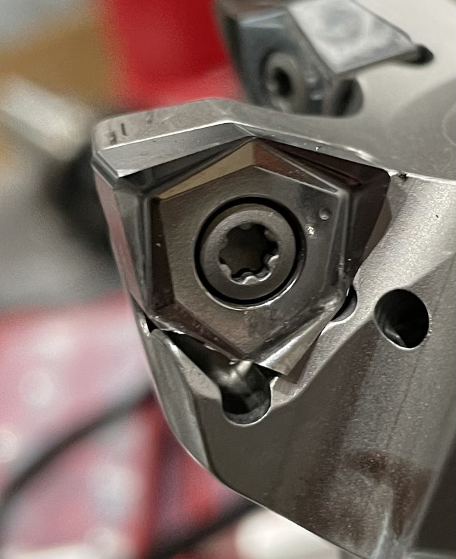

Failed to close op 2 vise and the 2.5" shell mill pulled a 3" round of 6061 out and into the door window, right at my face. :cryin:
Door glass done, new one on the way with shipping about $500 for the kit.
And 3 of the inserts broken. Anyone rotate and use inserts still after something like this or just trash them since they are not fully supported in the pockets anymore? The holder survived.

I'd go for a new insert in that case..

Replaced all 6 inserts with new. One was just shattered, like little shards as it fell apart. Amazingly the pocket was undamaged.
Forgot the rule of post crash check your offsets. Next part in that vice, was off. Vice was knocked out of parrellety. Sheesh. All costs are on me, but I should have remembered that just as a precaution. $4 of alum cost but still scrapped part vrs. maybe 60 seconds to hit the vice with the prob.

Nice to see others using trigon milling inserts as well. They are pretty bomb proof, but to an extent. Time to swap inserts.
