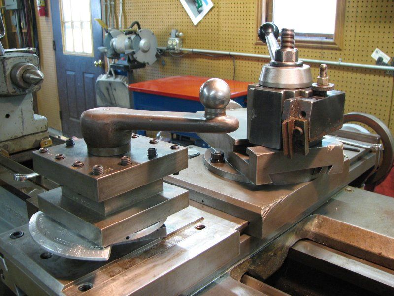

The bottom line, IMO, is versatility. With that in mind I recently scored an accessory mount for the cross slide of my Sheldon R15. Now I can leave the Aloris CXA mounted on the compound, and with adapters, still be able to mount other things on the cross slide, such as a 4 way turret, or a hell for stout Globe boring bar holder. ;)
This 4 way was made by OK Rubber, and the main reason I kept it is the 3 degree indexing capability it has.
I've never seen another like it.
I like the concept of the Globe because it keeps the boring bar centered over the anchor point of the holder.
