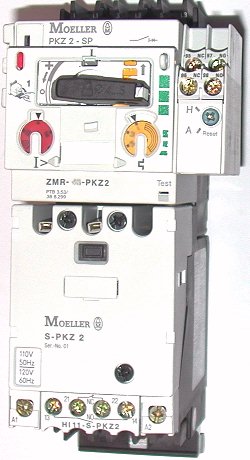

I’m having an issue starting a machine I just brought in - Wadkin BEM shaper / spindle moulder via my RPC. It will start and try to come up to speed for 2-3 seconds and then the overload / contactor / coil trips and cuts it off.
Shaper specs -
12 hp / 27.4 FLA @ 230v, 3 phase, dual voltage motor with belt drive to spindle.
Photos of the contactor / overload protection / coil below. I am not convinced that this is the right size for the machine at low voltage, but maybe someone can confirm.
The outside of the control box has a 480v sticker on it, but the (12 wire) motor leads appear to be wired for low voltage according to a few places online I saw, however current motor lead wiring does *not* match either schematic shown in the provided paper wiring diagram that I found stuffed inside the junction box so I scratch my head and pull at my beard....photos below of J box, paper diagram found and written diagram on the back of said paper that shows how motor is currently wired.
RPC - (photos )
Kay MA-2-R-VS 10hp with new caps and fed via #4 awg on dedicated 60 amp 230v breaker from main single phase panel. 3 PH MLO subpanel with (1) 30 amp Branch & receptacles and (1) 20 amp Branch / receptacles. Obviously I am plugged into to the 30 amp receps with appropriate plug on the machine in question.
This is on the edge of capacity for this RPC but I thought it would start it. Obviously I may have misjudged, but I’m confused about the contactor on the machine that controls the overload protection (Moeller), which is what is actually tripping. See photos, The highest setting for overload is 16 amps...which makes sense for the machine @ 480v but is way under @240v...but the motor seems to be wired for low voltage / 230v.
So the questions are - is my RPC underpowered? Is the overload protection / coil / Contactor wrong or underpowered for a low voltage setup?
Can anyone confirm via photos if my 12 wire motor wiring is correct for low voltage?
What am I missing?

You have a 5HP motor starter trying to start a 12.5 hp motor, makes sense to me that its tripping on startup. Starter was sized for 480V supply, you have half of that requirement.
The way I read this: The idler 10 Hp motor is connected to a 12.5 Hp target. The idler is running, the target is connected and 2-3 seconds the OL occurs.
The OL is caused by the target, not the free-running idler. I have used a 3 Hp starter on a 5 Hp motor for a long time.

I don't see where the comment about 5 HP comes from. The RPC is rated for a 10 HP start.
It comes from the rating on the manual starter, 5 Hp for 230 V and 10 Hp for 460 V.
A 10 Hp start at 430 V compared to a 5 Hp start at 230 V. Buy another starter? I wouldn't.
Unless this starter switch is going to be cranked for an elevator going up and down all day.
I use a 3 Hp starter with a 5 Hp motor for a lot of years. Still using the 3 Hp starter from 2001.
Not critical that the Moeller starter be upgraded. But it wouldn't hurt.
Since the use is occasional and a big dollar item I would not replace.
You see the little box to the right. An auxiliary switch that can be used with start/stop push buttons.

Is it not the undersized starter that’s what is tripping and preventing the motor from starting? 3HP starter on 5 hp motor is not 5HP starter on 12 hp motor.
It seems I need to either replace with a proper size and/or bypass the O/L to be able to properly assess if the RPC can start the load or not, no?

Do the cheap (no-dollar, low-dollar) tests first... You may be able to ID the problem positively.
The overload is not going to work well regardless. You have a 27A motor on a 16A overload, it's probably going to trip when you do not want it to, especially if you run it near full power..
The contactor, well, if it is rated low also, it is technically overloaded, and thus is being used "off data sheet". It may work fine or it may do something nasty like weld shut when you don't want it to.
If it is a US made contactor, probably fine. They tend to be rated conservatively. it appears not to be US however.
If european, as it appears to be, the rating may be different from what you expect. They are often selected to "just barely work", at the bare minimum rating to give acceptable life at specific conditions. I'd expect trouble when doubling the current.

Pics 2-4 are the switch box on the Wadkin shaper. The 5 HP O/L is on the Wadkin shaper.
The only photo I showed of the RPC in the original post was the spec plate from the top of the unit.
