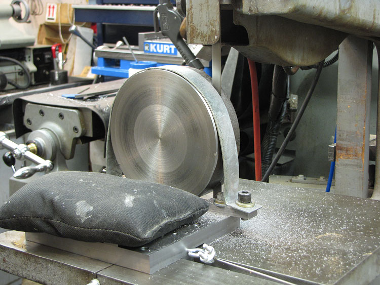

I manage it on my old Delta 14" band saw, with a simple slide pulled by a weight on a cable. Here I'm splitting a two-inch thick piece of 6" diameter steel:
That shot bag is just a bit of ballast because the stock is so short there's a bit of a balance issue.
For the full article on the saw modification: HomeShopTech
For aluminum, I'd use wood cutting speed and probably push the slide by hand.
