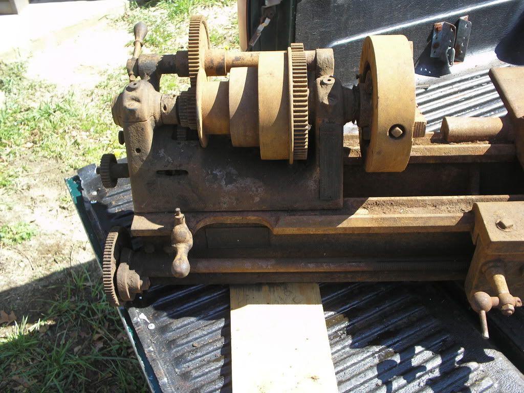

Hi. This is my first post here. I'm really a collector of antique woodworking machinery but every now & then I acquire an old metalworking machine to restore. Recently I bought some lineshaft equipment out of a closed shop in Newark. I also acquired a C. A. Mann metalworking lathe. Research shows that the Mann company only operated from 1885 through 1905 in Providence RI. I was only able to find one other example of this lathe. It's (mostly) disassembled in my shop now in preparation for restoration. Any information greatly appreciated. Here are some pics:
Despite it's rusty and neglected condition - I have yet to find a siezed bolt. Everything is stiff but moves. Items of note - double 'v' ways with the head & tailstock riding on one and the crosslide riding on the other. I'll be curious to see what's at the end of the spindle. Hopefully it's threaded. I'll post progress updates as they come along. Thanks for your interest.

Cutaways on both sides of the bed?
Welcome to the forum.
It's interesting to see that there are cutaways of the edges of the bed on either side of the headstock. At first glance, these appear to be clearances for the flat belt to go downward! However, they do not appear to be wide enough to allow all the steps of the cone pulley to be used.
If you enjoy tinkering, this will be great for you! Wonder what color it was originally? Wonder if it had pinstriping?

I believe, based on what I can see under the rust that the original color scheme was black with gold detailing. The only other one I've seen in picture was repainted light blue with red detailing. I'm leaning towards black & gold. I'm not sure what the cutaways are for. The belt design is to run upwards & to the rear & there is an interesting gear set up inside the headstock. I also have the countershaft but didn;t get pics of it yet. I run flat belt machinery in my shop.

Well, there you have the answer to the cutaways on the sides of the bed: right there in Tony's lathes site, it says: "Although offered with treadle-driven flywheel assembly, the example below lacks a hole in its headstock-end leg to accommodate this and would have been driven from either a separate wall or ceiling-mounted countershaft, or a factory's roof-fitted line shafting."
The cutaways must be a holdover from the treadle version!
The tumble reverse has something in common with a Myers lathe. The tumble gears are inboard of the left side of the headstock, but the lever is outboard of same. Up until now, the Myers was the only one I knew to have such an arrangement. (Not to be confused with a Seneca Falls where the tumble gears are inside and the reverse lever works in a vertical slot.)

If the 'tumble gears' are the forward & reverse gears they are located inside the headstock. I'll get a picture of them next time I work on the lathe. You can see in this picture
There is a small hole on the left side of the end of the headstock. There is actually another hole similarly located on the right side. These are oil accesses for the spindles for these gears. The lever on the lower front of the heafdstock is the forward/reverse shifter and there is a bronze yoke that moves the gears inside.
JRR
We have not seen the lathe's legs yet- it may have originally been treadle powered (and therefore the bed cutaways may not be a "holdover" at all).
Having the reverse gears mounted inside the headstock with the lever outside is a rather common design. Look through Ken Cope's lathe book and you will see several examples. Also, note that while the Mann lathe shown on the UK site has an external reverse lever, Joe Babbit's example and the lathe shown in the engraving in Cope's book do not.
I am guessing that the slot in the headstock and the lever mounted to the front wing of the bed both might have something to do with shifting the reverse gears, but I can't determine how they function from the photos.

There's a really good chance that the belt, when set on the largest cone step, will
clear the bed even though the cutout only covers the two smaller steps.
