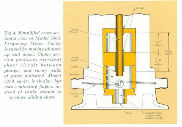

I have an interest in both electronics & machining and I admire the work in both fields done by HP in what I call the "electro-mechanical" era, when both elements were taken to a very high standard.
In my little "museum" of artefacts that interest me is a HP 536A frequency meter; in pre-digital days, these relied for accuracy on a very precisely-machined piston & cavity.
No doubt this man would have been involved in this precision-machining project.
