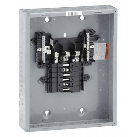

I would buy a proper 3 phase load center like the one attached below (12 Spaces, 125 A Amps, 208Y/120/240V AC, QO Circuit Breaker Type)
Won't I have the same problem with the "High Leg" in any load center if I want to have one single phase, 240 outlet? There will be one bus bar that is 206V rather than 120V, correct?
Depending on the location of all your boxes and RPC, you can feed the heavier 2 leads of your single phase panel supply directly to your 3 phase panel skipping the RPC. (thru a properly rated breaker of course) Then bring the single manufactured leg off your RPC back to fill in the 3rd spot on the 3 phase panel. This can make it easier and possibly cheaper to put the RPC in a location where you don't have to listen to it all day. Bringing only one wire back home helps that.
Back in the day I had my RPC in the basement fed off an existing sub-panel there. I only brought the Manufactured Leg back up to the garage to feed my 3 phase panel there. (The other two lines fed from the main single phase panel in the garage 1 ft away.) Worked perfect for over a decade.

Adair Orr
Aluminum
Joined
Apr 11, 2006
Location
Seattle
Hello again,
I decided to take a look at the IEM panel that I first posted. It was built so stoutly and it had copper busses so I talked them down to a ridiculous price and bought it. It sure seems like it should work.
I've updated my wiring diagram per previous discussion and with wire sizes from the RPC Panel manufacturer. I increased the wire size by 1 AWG for the 3 phase loads, from 10 AWG TO 8 AWG. I left the split phase supply at 6 AWG because that is what is supplying my existing 50 amp outlet.
If anyone cares to take a look and comment, I sure would appreciate it. I'm showing one split phase load on the 3 phase load center. It will draw only from the L1 and L2 busses of the panel, avoiding the manufactured leg L3. Will that work?
I have a couple questions:
1. What happens to the neutral (white) wire from the split phase supply to the RPC panel?
2. What do I ground the RPC panel, the idler motor, and the 3 phase load center to?
3. What do I do with the neutral from the split phase load going to the 3 phase load center?
If this is too specific, or presents a liability problem, please just let me know. This is a fun learning process for me.
Many thanks.
-Adair

13engines
Stainless
Joined
Jun 30, 2015
Location
Saint Paul, MN
1) Nothing. There will be no white wire in anything you do as far as hooking up machine tools goes.
2) I'd say carry a ground over from your single phase panel. Then ground your machines to the new panel. Seeing as that's where all the other wires feeding your machines will come from.
3) Again... forget you ever saw a white (neutral) wire.
