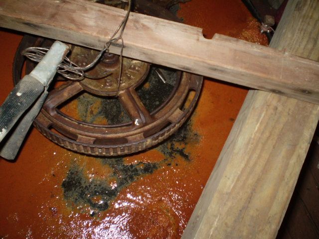

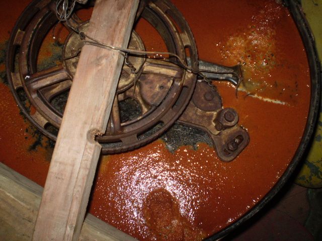

I inherited an antique reel push mower. One wheel was stuck so I whipped out the old trusty Electrolytic derustification vat that has been setting empty for a couple of years. After rewiring with heavy copper wire and fresh water washing powder and whatever I have a 35 gallon vat of lawn mower soup. And while waiting for the soup to finish been listening to some Red bone.
The soup

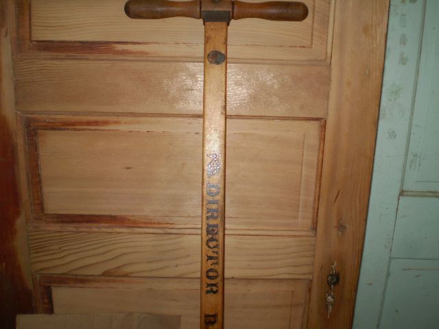

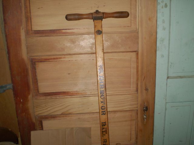

New Ebay handle.
http://i152.photobucket.com/albums/s164/james51robert/pictures095_zps3e9bff46.jpg
http://i152.photobucket.com/albums/s164/james51robert/pictures096_zpscd932ebb.jpg

Actually the finish and stencil are original. I came out of an attic apparently it had been there for a long time and the heat had blistered and turned the shellac almost black. I spent a few hours with an exacto knife carefully scraping it down to the original surface. The hard part is getting the dead shellac from the lettering without damaging it.

James, electrolysis isn't very good at going around corners, so I doubt that it's working on the corrosion inside.
Since it's a wheel at the outside, a shallow pan as deep as the wheel assembly and not much larger in diameter, maybe a plastic oil drain pan and a gallon of pool acid available at Lowes or Home depot for about $12 for 2 gallons, (not available in 1 gallon) would eat rust inside and not hurt the basic iron to any measurable degree in several days. Use it full strength.
Sloshing it up and down in the pan every so often will get new acid into the work area.
I won't say "don't put it in your eyes or drink it," too patronizing. Your hands will take a quick dip which will almost immediately start to tingle and should be rinsed off quickly, I do it all the time. Have a bucket of clean water close by. Vinyl gloves will let you play in it for a while.
Rinsing it well afterward will mostly stop the action but a bath in water with baking soda mixed in will kill the PH factor to normal. Immediately oil the iron because it will be so clean that the rust will kick right back in.

"James, electrolysis isn't very good at going around corners, so I doubt that it's working on the corrosion inside"
Got a couple of gallons of white vinegar that might work. Any thoughts?

Ok, I soaked the stuck wheel in vinegar four days and had to clamp the shaft i a vice while applying heat from a propane torch while squirting PB blaster to get the wheel freed from the shaft. I have painted the wheels and the gear housing and I am taking pictures as I go along.
I will post pics as soon as I can.
