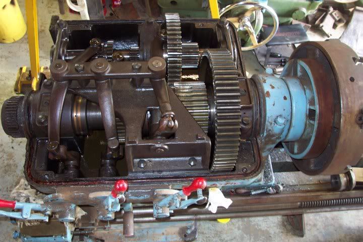

Early '38 Model G, very last of plain spindle bearing jobs with double spindle nose, no where near 18,000, which would come much later.
The post war 15,000 lb Model G had the "cabinet" legs and bed as one casting, and used the box ways like here. You can also see it has anti-friction spindle bearings and the massive L3 spindle nose. When the "G" was phased out about 1950 (because the 25" Model X had arrived), L&S ended 57 years of making lead screw only lathes:

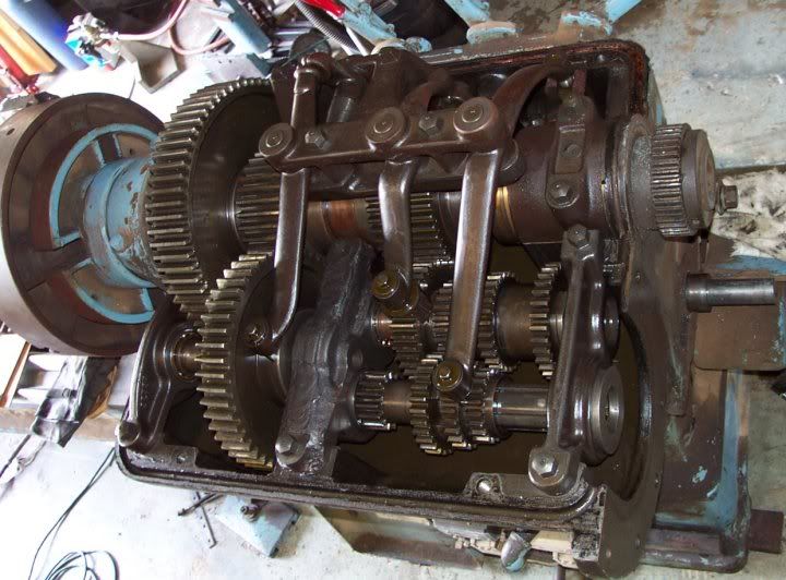

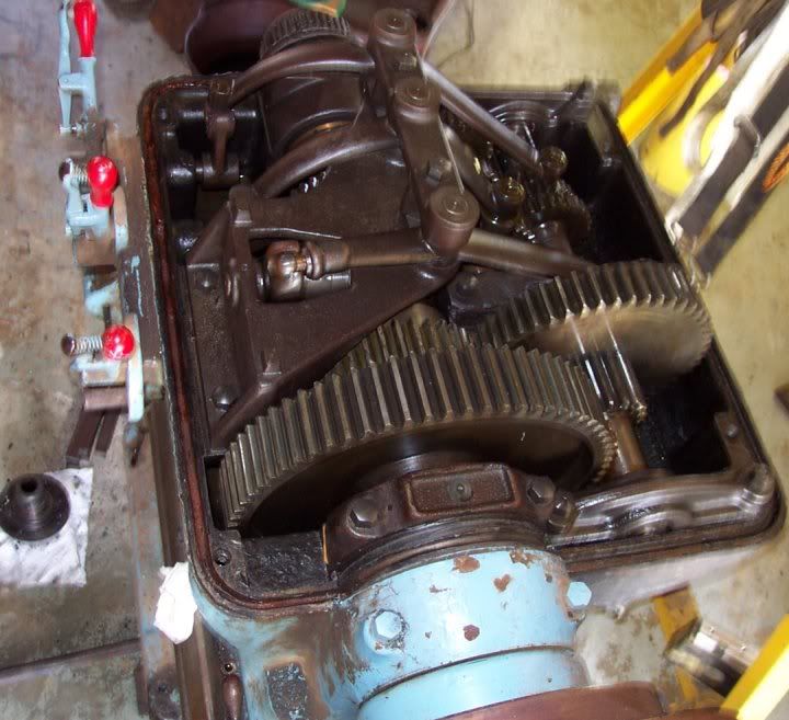

Head stock innards here:
http://img.photobucket.com/albums/v337/johnoder/24 X 168 LS/Headstock/DCP_0988sm.jpg
http://img.photobucket.com/albums/v337/johnoder/24 X 168 LS/Headstock/DCP_0989sm.jpg
http://img.photobucket.com/albums/v337/johnoder/24 X 168 LS/Headstock/DCP_0990.jpg
http://img.photobucket.com/albums/v337/johnoder/24 X 168 LS/Headstock/DCP_0991sm.jpg

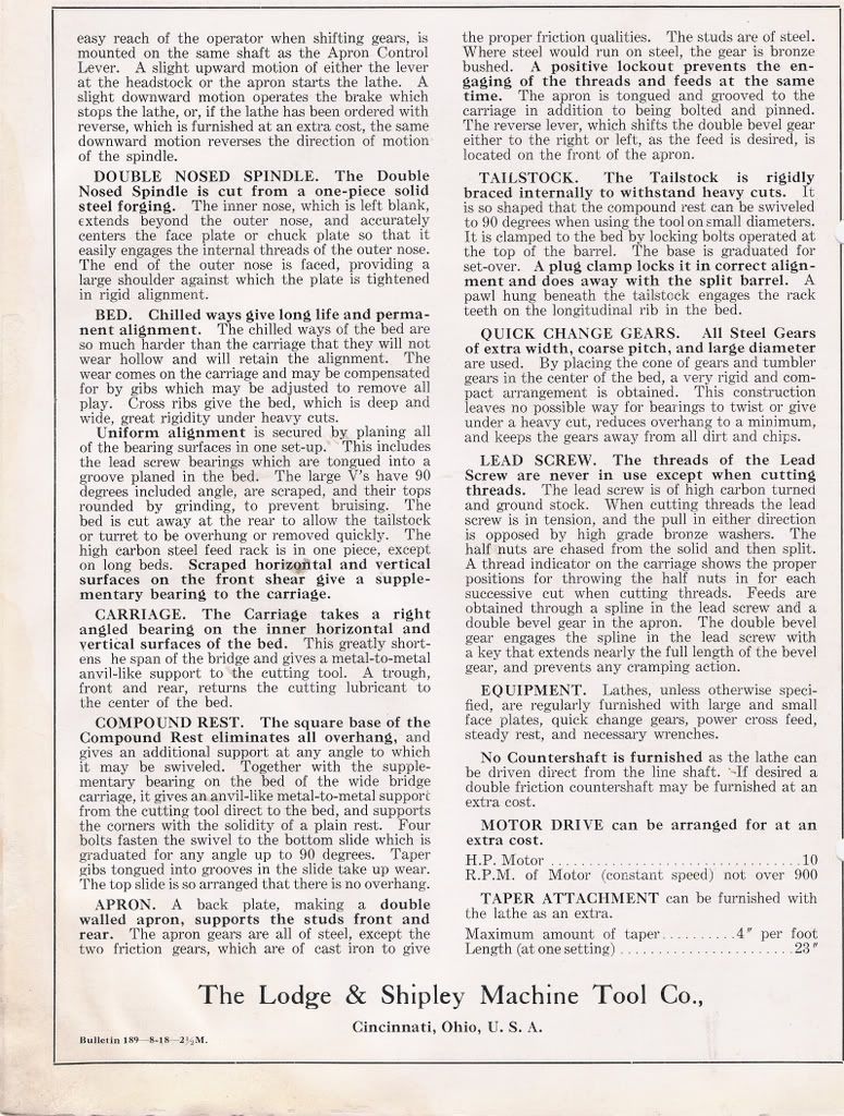

LS Manual pre1930 Photos by reelhooker1414 | Photobucket
Your machine is just an improved version of this 24" from 1916 - thanks to Mike C. for the scan:
http://img.photobucket.com/albums/v337/johnoder/L and S 1916 Catalog/LSpg44.jpg
http://img.photobucket.com/albums/v337/johnoder/L and S 1916 Catalog/LSpg45.jpg
On the mill catalog scan, you can thank Dave Hamilton for buying the catalog and Greg Menke for scanning and hosting it.
