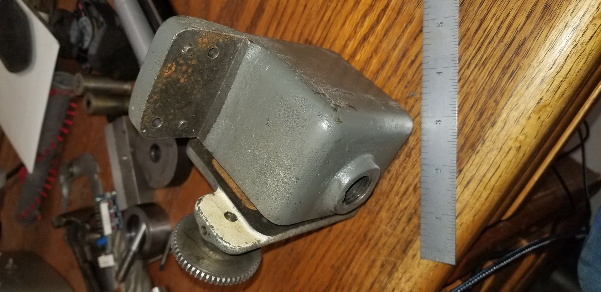

I removed the potentiometer box so I could tilt and drain - from the gear shaft hole.
On reinstall I wondered if it needed to be clocked in any manner - but it appears not to have any special relationship to knob position.
- it currently turns stop to stop - though it’s perhaps lore then stick as you noted.

A potentiometer is easy to test. They operate just like the graphic on the Sabina case. The two outside terminals have a constant resistance between them. The position of the knob will have no effect.
The center terminal goes to a brush that slides along the resistor. It goes from zero ohms to one of the outside terminals when rotated to one stop. As you rotate the knob, it will go to zero resistance to the other outside terminal. When the knob is in the middle, it will have half the resistance to either of the outside terminals. The basic idea is that the center terminal will vary its resistance smoothly from zero ohms to the specified ohms as it is rotated from one side to the other.
If you see the ohmmeter jump around as you measure the potentiometer when moving the knob, then it certainly needs cleaning but is probably bad.

Was fairly easy to test.
And... it seems to be operating properly.
No Ω movement on meter when the two outer terminals are connected.
But they move reasonably smoothly in opposite directions when tested with the center wiper and a single outer terminal.
Double checked.
15.7Ω in ea. direction at max.
Goes down near zero when turned the other way.
Suspecting my regulator assembly/control board may be the issue.

I notice that you seem to rotate your RPM control knob many times around. My modular drive 10ee speed control rotates less than 1 turn from lock to lock. Is your potentiometer original? Is the gear mechanism that connects the knob to the potentiometer OK? You can certainly test it by removing the 3 wires and using your ohmmeter.
The poteniometer is normally in a housing behind the speed control knob on the lower left of the gearbox. The connection is though a gearing that give about a 3:1 so the knob has to be turned several times for a full 270 rotation of the pot.
charlieman22
Aluminum
Joined
May 4, 2021
Thanks. Yes - this is my set up still.
If they changed the potentiometer itself - it remains in that housing.
I assumed that I would need to remove the gears from the front of the housing to access the Allen bolt and perhaps be able to remove the box cover?
As its testing alright - I am suspecting that I have something burned up on my control board.
Appreciate the photo and confirmation tho.

I'm lacking an exploded view of the speed pot component - perhaps someone can direct me to where I might find a download (assuming they are out there).
As for the leaking - from what I've read - user error is likely at least a component.
The new shop has the floor canted for drainage - which is how it sat when I filled.
But then I lowered the back off of blocks - and it was like a small tsunami of expensive oil finding its way out of the headstock and filling the speed pot.
Plan to level machine (level with the ground) on it's three points, then fill with fluids to determine if I have a leak issue - but knowing that it is moved sometimes - a drain on the pot seams like good insurance.

That is a Mil spec Allen Bradley pot. It is about as good as you can get. I don't know if they are actually waterproof, but they are probably close. Are you sure that it is bad?
Well - those are pleasing words to read.
My impression of Sabina: some pride there.
Quality build.
Not at all - and in fact - it tested well!
Sabina suggested I get a replacement - and when I saw new old stock for $40 - figured I would go ahead and grab it.
Perhaps it should just go on the shelf.
I wanted to open the casting that holds it and see how it was filling with oil/ have a look at viability of a drain.
See no reason not to add a drain hole - there is zero reason to let oil find its way in to that box and submerge the pot - even if it is top notch.
Going to be about a week before I hear anything back from the Sabina group.
From seeing your pic of the box/cover for the speed pot it looks like it should/could have a gasket. Maybe just have a 3 sided gasket that is open across the bottom so any oil that gets in can just seep out? Something thick like cereal box, not brown paper bag....
