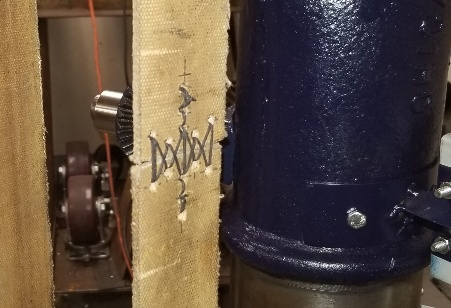

What kind of stitch pattern is used to tie the two ends together?
Actually, you can hand stitch rubber belts. The trick is knowing just how long to cut them so they're tight enough without pulling your stitching out. Here is a fabric belt I stitched on a previous camelback:
I believe you can do lacing like that on any flat belt you can punch holes in.
