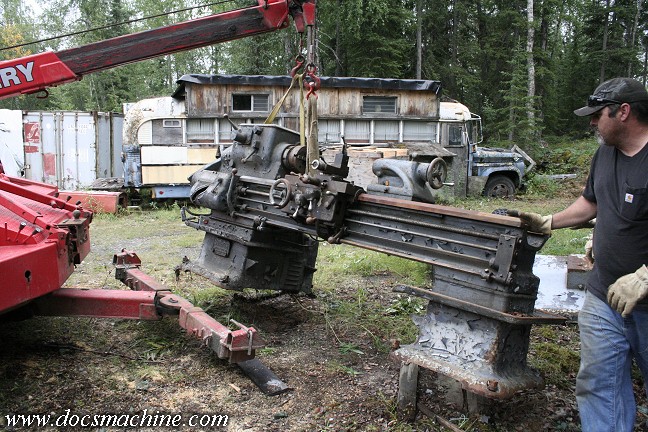

Last fall, I saw on the local CL, an ad for a '16" Metal Lave, Spring Sealed". Apart from a phone number, that was the entirety of the description. :D I called, and it turned out to be a 16" Springfield gearhead lathe. There was apparently some confusion between the seller and the person who actually posted the ad. :)
It was only about 30 miles away, so I drove out to have a look.
It had supposedly been sitting there for a year and a half, possibly two, but the deterioration of the tarp that had been covering- among other signs- suggested it'd been there somewhat longer than that.

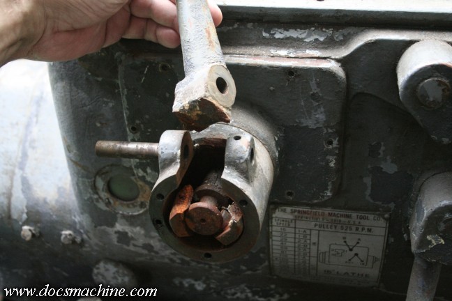

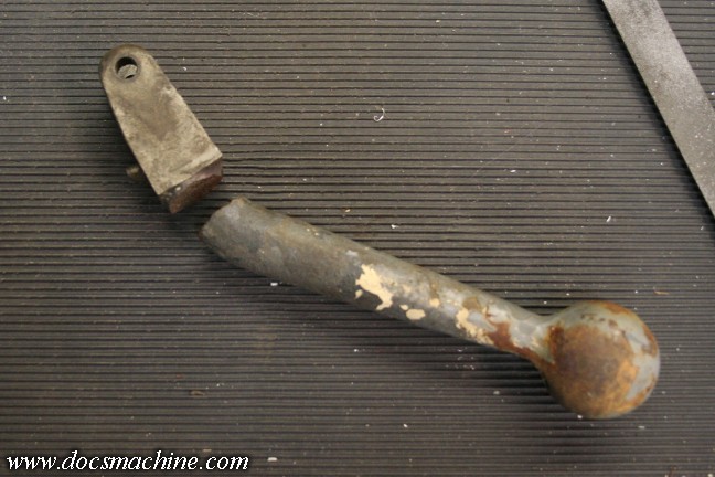

There was some damage, in the form of four broken handles, plus some wear, along with evidence of past repairs and crashes. The compound was not stock, the tailstock handwheel had been broken and badly rebrazed, the clutch handles had been broken and rebrazed, and one setting in the QCGB was marked, in hand-lettered paint, "oil only, do not use".
On the other hand, the castings all looked fairly sound, bed wear appeared minor- given it's clear prior abuse- and once I'd opened up the headstock, the gears and bearings looked just fine.
The price was fair (not much above scrap) and I thought that most of the problems could be fixed, so I decided to buy it.
I got it home with minimal trouble, though the scale at the truck depot up the street wasn't working that day, so I wasn't able to get an actual weight. :D To unload, my neighbor brought over his 966 with some forks, and set it on the apron of the shop. Heavy equipment makes that kind of thing easy. :)

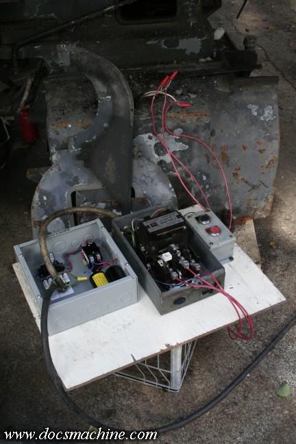

Now it was time to properly evaluate the machine. Obviously I wasn't able to run it under power where it'd been stored, so I was taking a chance of buying a pig in a poke. So before I spent too much time or treasure on the thing, I wanted to get it under power, to at least evaluate the headstock and gearing- if something was missing a tooth in there, chances are it'd be time to just scrap the whole works...

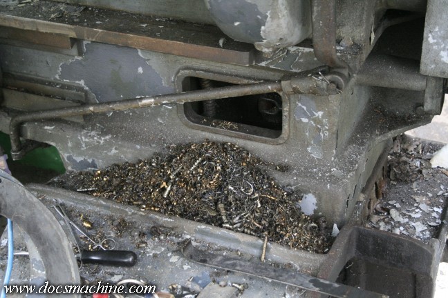

So I cleaned some of the old chips out of the QCGB...
Drained, filtered and replaced the headstock oil...

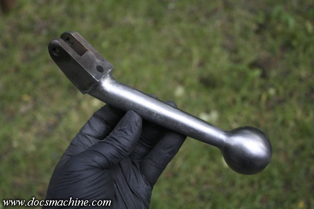

Fixed two of the broken levers...
Hooked up a temporary static phase converter...

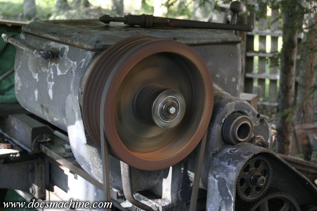

And fired it up!

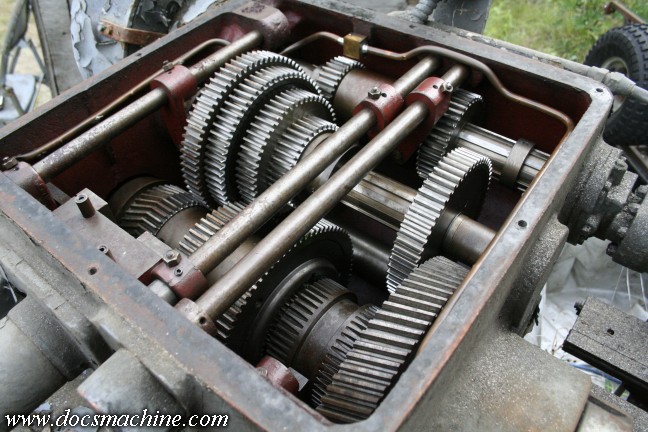

The gearbox proved to be in fine shape, with no real noises beyond the usual straight-cut spur gear whirrs. The repaired shifters worked smoothly and firmly, the oil pump worked just fine and with plenty of apparent volume, and the clutch was quite positive. Most any other damage I figured I could repair, as long as the headstock was okay, and no major castings had significant damage.

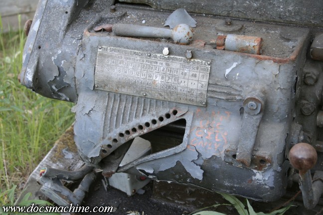

Unfortunately, winter was closing in fast, and both the mechanical issues and the dirty/rusty condition meant I couldn't just hose it down, give it a coat of porch paint and call it good. :D In the next installment, we'll start pulling it apart and doing a more detailed evaluation of the overall condition.

Got a laugh out of that school bus with the clerestory roof added to it. Perhaps it had become a mobile chicken coop that makes house calls? Their motto could be "STRICTLY Fresh Eggs delivered right to your door!"

Since this post has the dual purpose of archiving some Springfield info for other potential owners, I'll be adding a little extra info at times.
The repair started out with removing the linkage of the broken lever. I opened up the headstock in order to remove this tapered pin, which would release the shift fork and let the shaft slide out.
And, as I was checking it over to see how it comes apart, I noticed something interesting...
The entire outer lug, which holds the lever in place and mounts it to the rod...
... is solid cast brass. Or possibly bronze. Removed from the shaft, it weighs over two pounds all by itself. They knew how to make 'em back then. :D I have a hard time seeing something like this on a modern lathe even made from aluminum- chances are the best you get is die-cast zinc, if not just straight-up plastic. :)
There's a reason some of this seventy-year-old stuff is still being used today.
Anyway, here it is partly disassembled.
And my patented Sherlockian powers noted that sometime in the past, the original detent springs broke, and rather than dismantle the mechanism as I did, to replace it, somebody stuffed a couple of more or less workable replacements up there.
The one ring at the lower edge of the photo is a fragment of the original spring. It was an inch or so long, and fit down into a recess in the cast-iron lever. The replacement was just wedged up into the gap and left there.
I also found out how the assembly comes apart- turns out I didn't need to remove the whole shaft, the taper pin on the brass block was hidden under multiple layers of paint.

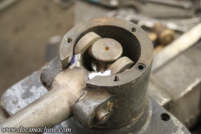

Anyway, with the parts loose, it was a simple matter of a quick trip through the bead blaster...
You can even still see the core wire from when the handle was cast. :D
The actual welding was simple: I started out by grinding a deepish vee on the backside...
And laying in a quick bead of the Muggyweld rod. I then just laid a piece of fiberglass insulation over it and went and did something else for five or ten minutes. Then I veed out the front and welded it, let it cool, veed out one side, welded it and let it cool, etc. until it was done.
I don't have any in-progress ones of the forked shifter, but the idea was much the same- the broken ears fit back in place rather cleanly, so I tacked 'em while I had a good mesh, ground a vee, welded a seam, let it cool under the fiberglass bat, ground the next seam, and so on 'til it was done.
Now, for a larger or more important casting, you'll want to be more careful- Muggy suggests that pre and post heat is not as crucial as it is with other welding processes, but iron is iron, and heat is heat. I did eventually reweld a previously-repaired crack in the headstock base foot, which worked out fine, but I paid a lot more attention to heat and cold.
Anyway, that got me a functioning headstock again, and I was able to test it as noted above. However, later, as I was dismantling the thing to move it inside, I got a strap in the wrong place on the headstock, and rebroke the forked shifter. The ears broke outside of the welds, showing, if nothing else, the welds are at least as strong as the parent metal. :D
So later, I had to repair the shifter by milling a steel yoke and grafting it on, but we'll get to that shortly. :)

The QCGB was also so badly clogged with chips...
That I didn't want to try a feed or thread, lest I damage the gears even further. On top of that, the bed was rusty and I didn't want to move the carriage around on it too much, and basically everything was filthy enough I wanted to minimize any further damage I might be doing by moving stuff around.

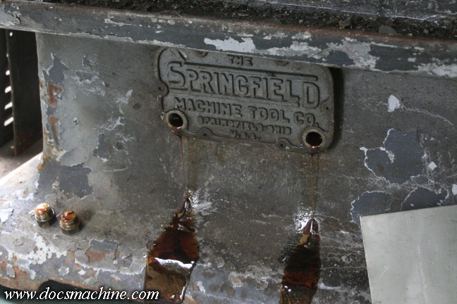

Looking under the dataplates and other spots that suggested original, stock paint, the color was apparently a somewhat darkish grey, with just a hint of blue. I already had a darkish selection of an alkyd enamel I'd been using on other machines (called "Noble Grey") which was a surprisingly close match, so that's what I'll be using during the rebuild.
