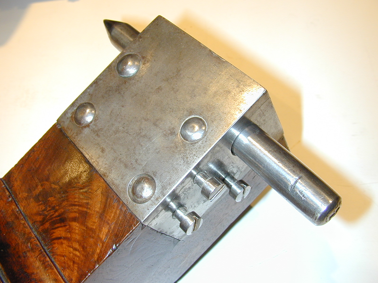

The tailstock holds the lathe center (duh).
http://billwebber.galootcentral.com/2110-001.JPG
A relatively crude post extends from the bottom of the tailstock assembly. A threaded ring and a wooden block allow the tailstock to be positioned and secured in place.
http://billwebber.galootcentral.com/2110-002.JPG
The metal parts that carry the lathe center appear to be overly elaborate. The metal box is hollow and is mostly wood inside. In this picture you can see the outside plate and the box that may be 3-sided or 4 sided. The three screws that stick out from the end do not appear to do anything by themselves. They have machine threads and are screwed into the tailstock until the screws bottom out on their shoulders. I suspect they were intended to hold some form of accessory.

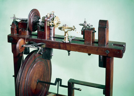

So again, care to comment on its age or manufacturer? My guess, again, would be it was used for instrument making, telescopes, microscopes, sextants, etc. I think it was likely intended to be powered by pedal or an over line shaft of some sort. I was searching the internet for other lathes like this one. I’ve found pictures of two other lathes that appear to have a similar threading capability. Doesn’t mean much other than the threading design was not uncommon. The pictures I found were an advertisement for the picture only. No other info.
http://billwebber.galootcentral.com/Example1.JPG
http://billwebber.galootcentral.com/Example2.jpg
Another picture of a lathe with a similar threading box is here.
https://emuseum.history.org/objects...e;jsessionid=DBC19028BD4749958D2295F001B59FA3
The picture cannot be copied but can be nicely enlarged. Attributed to William Walters in England about 1804.

Bill,
Many thanks for providing those excellent and comprehensive photos.
At first sight, I would say that this 'gentleman's lathe' could have been made as early as the late 18th C. However, the stamped numbers on the division plate raise doubts in my mind. I wonder when number stamps in that 'font' first appeared? Incidentally, the font style suggests English origin to me, rather than French or German.
Is the hole in the spindle tapered? I know that round tapered drives were occasionally found in the late 18th C, but in my limited experience of early lathes, square tapered holes were more common in lathe headstock and tailstock spindles.

Hi Asquith, Interesting observations. Index plates have been around since at least 1775. There was a numbered index plate on a gear cutting machine in the Dominy clock shop. With proper accessories, the index plate could be used to cut gears. FWIW, you can tell the numerals were stamped individually on my lathe index plate. I cannot even guess about the font.
No, the hole in the spindle is not tapered, it is actually threaded. The spindle with both internal and external threads is remarkedly similar to my 1970s Hegner lathe. I'm not suggesting this lathe is that new, only that the concept of internal and external threads for the spindle is a lot older than I would have guessed. I'm thinking the this type of spindle would be later than the tapered spindles used on earlier lathes? I'm still thinking 1800 - 1870, but closer to 1850 +/-?

Look up Bergeron's Manual du Tourner and you will find a nearly identical lathe. They had a shop in Paris, I wrote about them in this post. The book came out in the 1790s but the 1816 2nd edition is the best. It was volumes plus a plate atlas. It is one of my favorite books.
Very Rare 1816 Vernier Caliper is now in my collection!
The lathe probably dates from 1790 to 1830. I saw it in the auction but have to be very careful buying big things because I am out of room. In Bergeron's book they show many detail plates of this type of lathe construction and what the base would have looked like.
