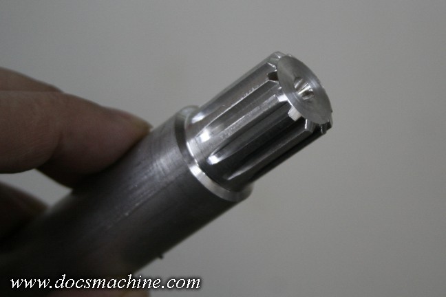

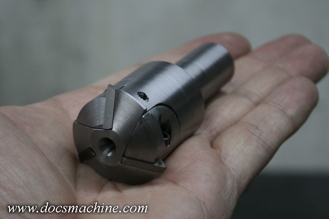

One of the ones I posted in that thread was this indexible cutter:
It holds three TPG-type triangular cutters, pointing straight out. With a bit of a careful touch-up to the tips with a diamond wheel- which incidentally lets me reuse dull inserts from the scrap can- it'll cut 60-degree splines:
(That's just a test piece- the final part was in 4140.)
Doc.
