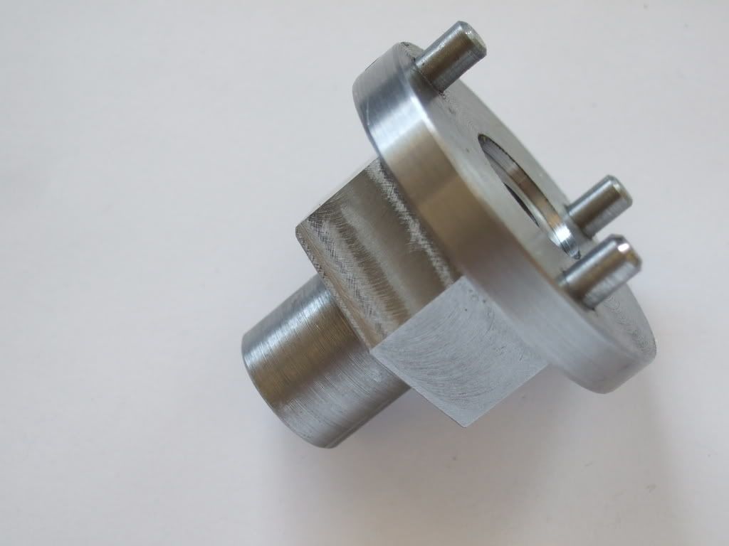

The sight glasses are tough to get out without damaging anything unless you make a three pronged tool to twist them out using the screw holes once the screws are removed. Here is a picture from this forum of the tool I'm talking about. You can get the cork gaskets from Monarch I believe, but I just used rubber o-rings instead. Easier, cheaper and reusable if you take the glasses out again in the future. Place one on each side of the glass.

To remove the sight glasses you need to twist them to break them free. Basically you need a pin-type face spanner. HR's tool, above, is one way to go. Folks have also used face spanners sold for bicycles (Park Tool sells them) and for opening watch cases (HF has them). A couple of holes drilled in a piece of bar with appropriate sized pins works as well.
O-rings are definitely the way to go. Topics related to sight glass removal and O-rings are discussed here:

Thank you for all the info on the oils. Where can I get that sight glass removal tool or is it a homemade item?

Thank you for the oil info. Too bad about the DTE light! Looks like it’s going to be a hassle to get some. I like HR‘s tool. If it’s a homemade thing then I’ll probably just make one from bar stock and pins as you mentioned.

Stricht8, Take a small brass punch and round the end slightly. Insert it at an angle in the screw hole of the sight glass plate and just tap it with a hammer til the ring begins to turn. Done deal. You can pull the ring, cork seal and glass right out. Pick up some cork gasket maker at Auto zone ad pop out your own gaskets. Its cheaper and works just as well.

I like this simple approach!
