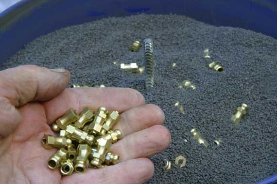

I make batches of small brass parts, some with rope knurling or other decorative bits, and toss them into a small round vibratory tumbler with crushed walnut shells (lizard bedding from the pet store) and squirt in some Flits polish. Overnight they get a nice high shine.
If memory serves, the tumbler was about a hundred bucks on eBay - sold as a "pinball polisher"
This is a very nice looking result!
