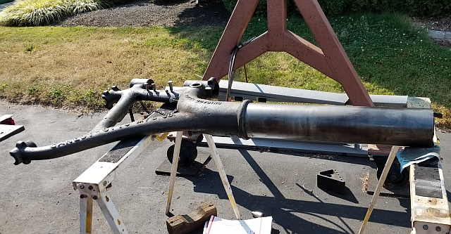

I forgot about the other pics, I removed the two piece wishbone looking part that has the motor mount plate, double V belt pulley and the flat belt pulley before we moved it. So I have all of those parts along with the belt, though it has a few cracks here and there.
The table is in pretty good shape, couple of marks here and there, but no big chunks or holes missing. Was thinking I might chuck that up in my lathe at work to skim the face and sides of it.
I had to move the table and quill support down for transport, definitely a bit sticky and gunky, but they moved without much effort. The spindle and drivetrain all spins pretty smoothly by hand.
The table support is like a two piece clamshell around the column, a feature I haven't seen before yet. So I'm taking that apart today to clean the column up, it looks pretty good already. Not sure if I'd want to mess with pulling the base off. Getting it lifted with my toe jack to bolt my rollers on was enough fun already. I'd really hate to tip it over and ruin it.

How do you go about tipping these on their side? It's nearly 8ft tall and I'd say 1500-2000lbs. It's actually at my friend's shop currently as it's too tall to get through my garage door.
I have a shop-built gantry crane in my shop driveway. After I got the main column stripped down completely I picked it up from overhead and was then able to put it down on sawhorses:
As far as getting it into my garage I built a lowboy rolling base that holds the machine only 3/4" off the ground. I don't know if you did that if you could get it into your garage. If you can get it in front of your garage you may be able to catch it down low and skid it in on its own base. Take some measurements before you give up. I don't have a picture of that machine base but I can point you to right now but I can post one later if that would help.
