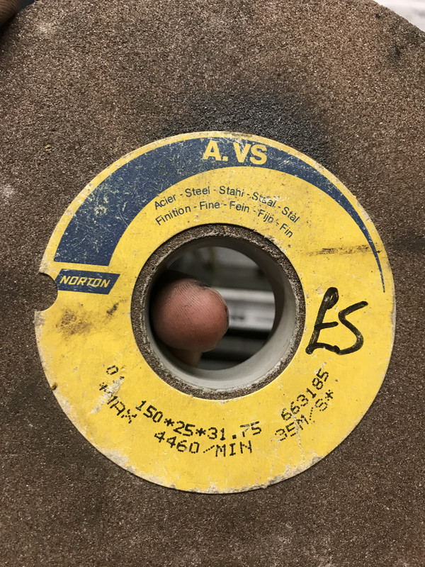

My surface grinder came with an assortment of grinding wheel shaped things.
Some were clearly for bench grinders, or bigger / different machines - they would not fit the spindle or wheel guard. However there were a few the looked possibly correct for the machine:
I think this one might be for off hand grinding?
I can see no markings that indicate abrasive, grit size or bond structure. I tried to find A.VS info from Norton but came up blank. Any ideas?

that 150 may be a 150 grt so a very fine finish wheel, its difficult to tell just by looking because som wheel are very opeen so have more space between grits.
