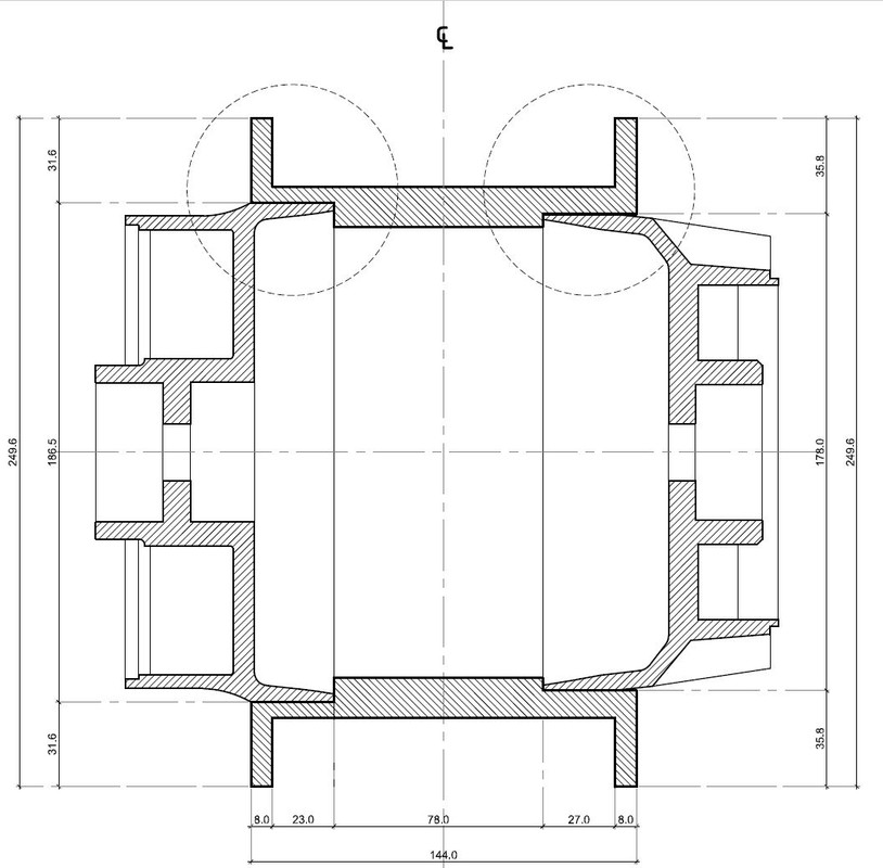

Let me try to break it down in basic info:
- shaft would be T6 al, 180mm OD, 7mm wall thickness
- Hub would be T6 as well, 180mm ID, 245mm OD
- Engagement length would be 30mm
The idea is to shrink fit the two parts after bringing the Hub @ 100C (by boiling it) and the shaft @ -70C by dumping it in dry ice. I estimate the actual temp of the two pieces to be 80C for the Hub and -50C for the shaft, even if I move fast during assembly.
My questions are:
- Does it have a chance to succeed of am I setting myself up for failure?
- What should be the max and min diametrical interference?
- If I were to select the median between max and min diam. interference, what max torque could the assy handle?
The idea here is to sort out if the assy:
- is realistically doable
- Has any chance to withstand the torque forces of acceleration / braking without additional operations. If it's a lost cause then I guess that another option would be to dutch pin the assy but it would be quite tricky due to the shape of the parts. Sure thing is that I want to avoid welding because on such a circumference, it's pretty much a given that a substantial area of the assy would reach annealing temp.
I'm really embarrassed to bother you with questions that are probably very dumb, but as stated above, I'm just out of my league...
I've dropped the idea of the assy interference withstanding the whole torque forces applied to the hub, and instead have opted for an array of threaded pins to secure the parts.
I nevertheless need a tight fit with a certain level of interference between the parts.
I intend to boil the hub to bring it to 100C, as mentioned earlier, and to submerge the shaft in a bath of dry ice + acetone or dry ice + alcohol (I would prefer alcohol for smell / volatility reasons but it seems that acetone works better...) which should bring it to -70C.
I think I can attempt the assy within 10s of the parts removal of their respective hot and cold bath. It is a complete guess, without any scientific calculation behind it, but I assume that the parts will respectively 80C and -50C at the time of assy (please chime in if I have grossly underestimated this).
If I apply the formula:
Diametric interference = temperature differential x coef. of linear expansion x diameter before expansion
or
Diametric interference = 130 x 0.000021 (taking the less favourable coef) x 180 = 0.4914mm
So let's say I play it safe and give me a margin of error, to make the assembly more forgiving, of 50%, that would be a Diametric Interference of 0.25mm
Does that sound right? Am I leaning towards a complete success (=drop fit) or an embarrassing failure (gross miscalculation leading to shaft stuck in hub half way, interference so low that the parts could be pulled off by hand, interference too high making the shaft crack, etc...)?
.25mm is a lot of interference for parts with a 180mm diameter. I would suggest thinking more about how the forces work on these parts, and what are the failure modes (what happens if they separate).
From that, start thinking about the tolerances you'll deal with with the two parts. You are unlikely to have perfect diameter control for every part you work with, so you have to plan for lesser and greater than ideal interferences too.
I'd suggest showing some design drawings here to get better advice on how to approach this assembly problem.

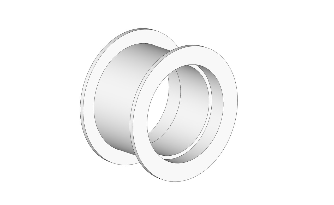

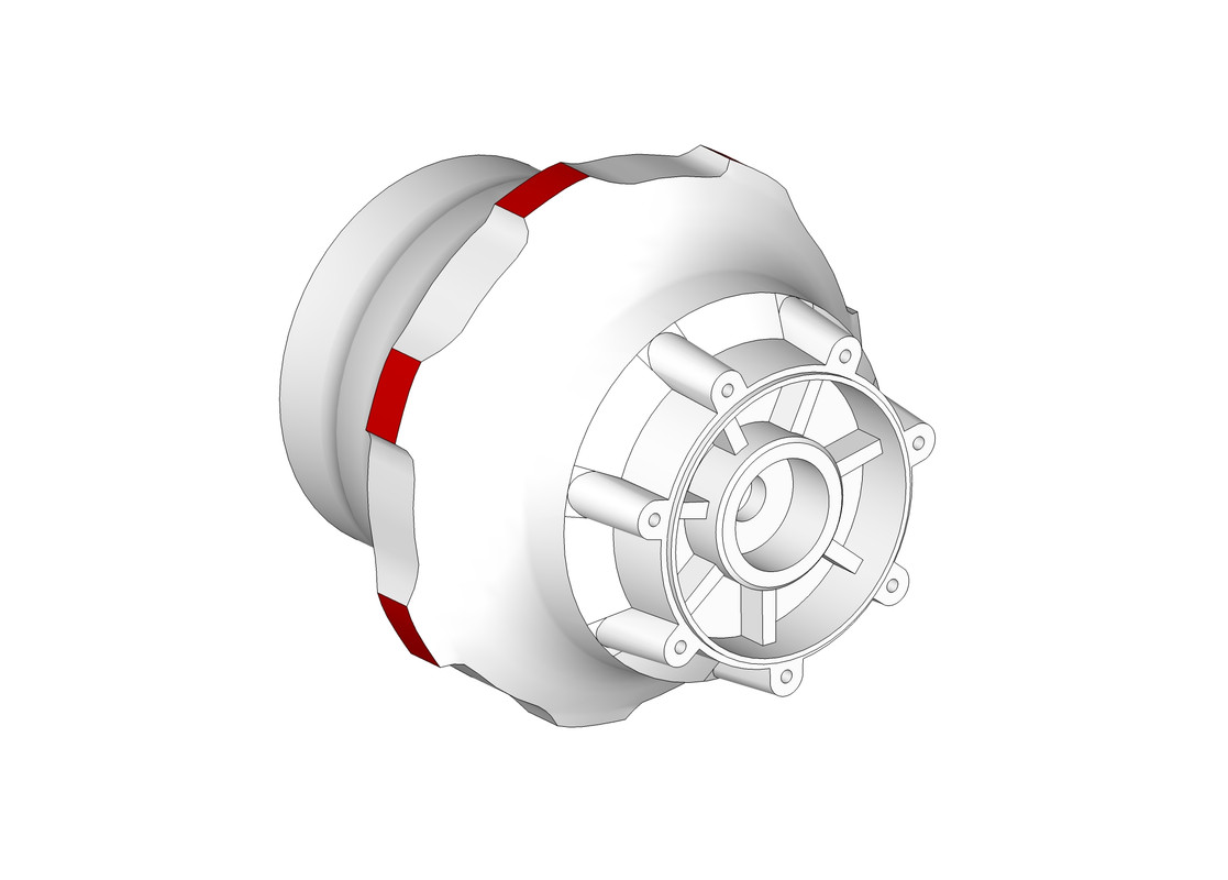

Here are some sketches / drawings to help you understand the concept:
The Drive and Brake sides of a stock cast Al wheel have been lathed. Process sketches:
And parts cut:

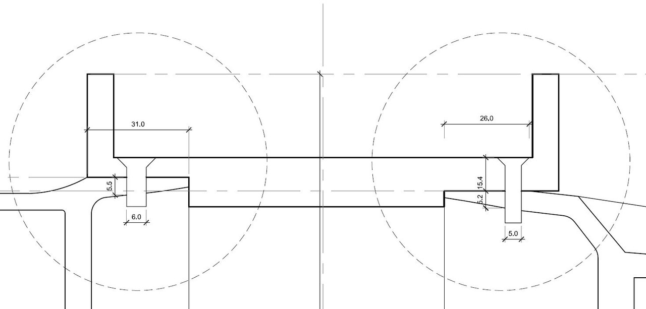

Next, the idea is to machine a Hub and to shrink fit them in. Hub sketch and section:
Concept section drawings with some dims in mm:
Then to pin the parts together with 6xM6 screws on the Drive side, 8xM5 screws on the brake side:

I'll start this by saying "I am not an engineer", and while I do mechanical design professionally, it's guided by experience ("gut"), and not calculations.
That said, I'm worried about the three-part assembly, both from a strength and fatigue life standpoint (thin cast Al parts mated to a heavier center cylinder), the localized stress aspect (each of the fastener points is a stress concentration), and the overall alignments of the three parts if still a vehicle wheel application.
Between those worries, and the preparation requited to split and modify the original wheel, I'd think that a "clean sheet design" might wind up being safer, stronger, and cheaper to accomplish.
With modern 3D printing capability, you might be able to model a new part, print a casting core from a low-temp plastic, and have a fresh part cast as a whole. That, or simplify aspects of the design to allow it to be machined from solid.
You'd still want to confirm that stress and fatigue life is adequate for your purpose, having wheels fail on a passenger vehicle is generally not a good thing...
As I understand your concept, your shrink fits have nearly zero strength. Dependable shrink fits need heavy sections, your cantilever section doesn't qualify.
I'm not sure I understand, what do you mean by cantilevered? It's basically a tube fitted in a tube, I probably understand "cantilever" wrong because the way I understand the term, I can't find anything cantilevered in the assy.
Can I just say that even without a shrink fit, just being what we called a " size and size " fit, pressing an aluminium component into another aluminium component stands a pretty good chance of " galling up " on the way in.
Regards Tyrone.
Yes, that's what I've read and the reason for attempting a shrink-fit instead of a press fit. My understanding is that the Al galling during a press fit is caused by the combination of the friction and the material elasticity. Shrink fitting, I assume, should nullify the friction since it would be, ideally, a drop fit. Same concept than dropping a frozen bearing in an Al hub heated at 100C.

Alright, so no, I didn't die in traffic either :D
Long story short, it took me ages to source the bloc of Al for the hub machining, then life got in the way and I sat on it for a solid couple of months. I took it out of its wrapping yesterday, and here it is in his shiny glory:
The rims for the spokes are a tad over dimensioned to leave me some slack when the wheel guy and I have sorted out their final height / thickness.
The plan has already slightly changed, and I guess it's not too stupidly planned since pretty much everything I have in mind have been mentioned in the latest posts ;)
- I will be a bit more modest in the interference, bringing it down to 0.15mm from the originally planned 0.25
- If I managed to shrink fit both sides, I will then indeed tap set screws. There's not much meat left in the brake / drive sections there (approx. 6mm) but they won't bear the brunt of the load.
- The final step will be to weld at the contact between hubs and the brake / drive sections
Currently the diameters of the seats on each side of the hubs are a few mm smaller than needed. I get it machined "step by step" because communication is challenging with the language barrier. I can shave off some material but not add any, so the next step is to bring it back to the machinist and to get them enlarged to the right diameters to attempt the drop fit.
@Strostkovy: there is a steel tube between the two bearings, that's standard bike wheels construction, it's just not shown on the drawings.
Thank you all for the inputs, keep them coming, on my side I'll keep posting updates as the project goes
