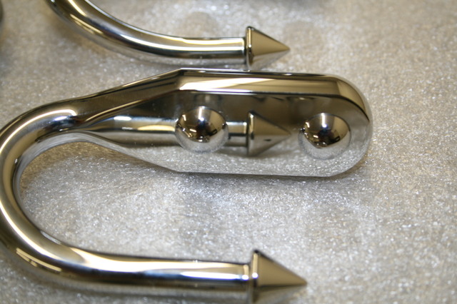

    Man, You cats are the BEST!
    I bought the ONLY 6" diameter, 1/4" stitch, buffing wheel in Stephenville Texas, on the way home. Also picked up some Tripole? red buffing stick. Didn't get the finishing buffer wheel because it was a 1" stitch and needed a 3/4",( I think).
    Got home and made a spacer for the grinder turned buffer on my handy dandy BP ezpath. Turned the repurposed grinder (new buffer) on and doped up the wheel with the red. 5 minutes later I'm covered in nasty whitish fibers and holding a part on an arbor, (wear gloves, as advised, HOT), that looks incredible! Buffed perpendicular to scratches.
    Hit them with a 4" wheel in my air grinder with white polish, for about a minute, and they came out great.
    I will not buff in the lathe again.
    Thanks for the advise and the help!
