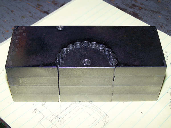

On say just a B-port I'd probably drill a bunch of holes around the circle, knock out the slug and then get out the boring head.
Even on a cnc mill I'd do likewise.
Turning and boring is faster cutting than drilling or milling but a whole lot of material is made into little chips needlessly.

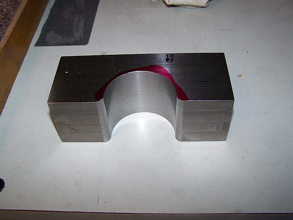

I did a similar thing in 1-1/2 or 2 inch steel about 3 years ago by chain drilling, bandsawing, and boring.
...lewie...

It also depends on if you want both halves usable or the same size. You will lose your kerf size on whatever you cut it in half with. It really does make a difference if you want the 'best' way for the equipment you have on hand and want to do yourself, or if you are sending it out. EDM would be pretty much perfect, but also by far the most expensive. All the other methods will work. Personally, I'd probably either just turn it to chips and surface in the cnc or chain drill and saw it out and then surface it. Probably the first since it's way easier to click a few more buttons and have the cnc hog it out.
Lewie, that looks really good. I'd be concerned with keeping my bore parallel to the bottom of the workpiece, which is pretty important, going down a 6" travel.
