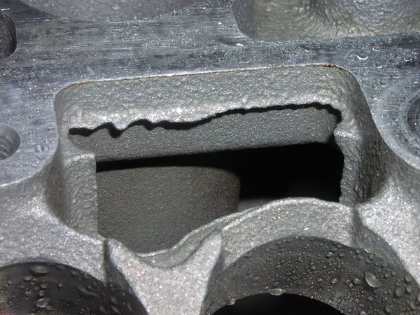

    I have a cylinder head apart right now, and am wondering what the best way to remove carbon deposits from the valves and cylinder head, particularly the exhaust ports.
    The head is an aluminum head, and standard (not SS) valves. I have tried a wire wheel on the exhaust valves, but the deposits are pretty hard and heavy.
    Any good chemical solution? If I drop the head off at an automotive machine shop to have it hot tanked, will that remove the carbon or is that a seperate procedure?

    for the valves ...wire wheel on a bench grinder .
    following is old post of mine copied to here
    The combustion chambers and the ports were cleaned with paint stripper and toothbrush....here you see the old carbon just dissolving on contact with the paint stripper and oozing out. .
    Make sure you wear goggles..
    Caution only use methanol type paint stripper, should say on the label methanol or methylene-dichloride
    other paint strippers contain caustic ...that corrodes and turns alloy black
    After a rinse it will look like this.
    I also cleaned the cavity ,above, around.inside head were lots of dirty oil residue accumulates..
    This I did with paint stripper,toothbrush,paint brush ...and pressure washer.
    all the best.markj
