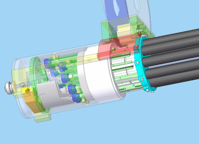

    I just recently came across the RGG plans that a friend at work bought several years ago. We hope to make at least 3 or 4 of these little gatling guns. (One as a gift for the boss, for letting us use the machines to make them).
    Does anyone have any links to pictures of the finished or partly finished RGG gatling guns, other than the ones on the RGG site? It's hard to judge the scale of this thing.
  10. #30
    Join Date
    Apr 2008
    Location
    Central FL
    Posts
    6
    Post Thanks / Like
    Likes (Given)
    0
    Likes (Received)
    1
    Default
    PS I have drawn most of the RGG gatling gun up in 3D, Here are some screenshots.
    I'll add more pictures to this album later.
  11. #31
    Join Date
    Apr 2008
    Location
    Central FL
    Posts
    6
    Post Thanks / Like
    Likes (Given)
    0
    Likes (Received)
    1
    Default
    got started on cutting some parts. I re-designed the whole gun based on the RGG prints, but easier to manufacture (for me at least). Lots of laser cut parts, includeing the Box cam. which I video'd being cut here:
  12. #32
    Join Date
    Feb 2006
    Location
    Northern LP of Michigan
    Posts
    681
    Post Thanks / Like
    Likes (Given)
    0
    Likes (Received)
    3
    Default
    Quote Originally Posted by dogon1013 View Post
    That laser is cheating
    Years back when I programed a non-abrasive waterjet and still had dreams of building an experimental category aircraft, I planned to cut the wooden wing ribs out with the cell at work.
    Clutch
