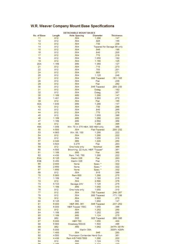

Another way would be to take a weaver style or picatinny base and screw it to your existing hole and sweep the top of it with an indicator. Grand Slam steel bases are flat on top. If you dont have the base with the exact radius on hand you could order one off the chart below, or use one with a lesser radius so the sides of the base form a kind of V block. Still have to shim the barrel for taper, and account for the base not being in alignment with the longitudinal axis of a tapered part, but it will get you good on the Y axis. I use paper shims on 3 sides 1/2 the difference of the taper over the width of vise jaws. In my case 6". Not flashy, but this will get you well within industry tolerance for scope mounting, etc.
