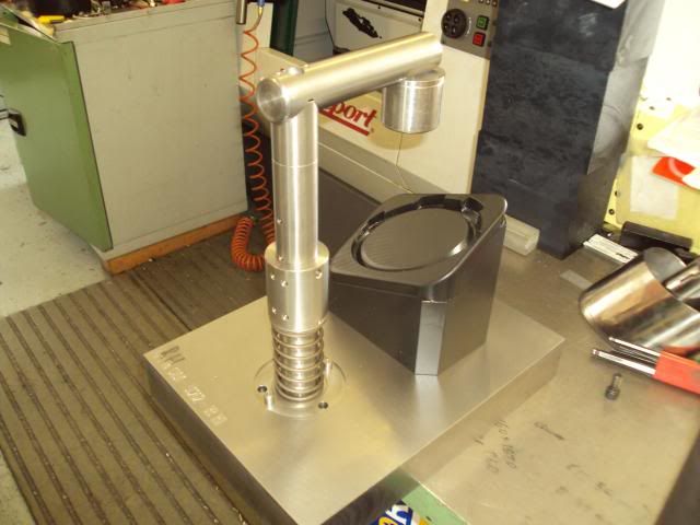

    Thought I`d share my budget pre setter
