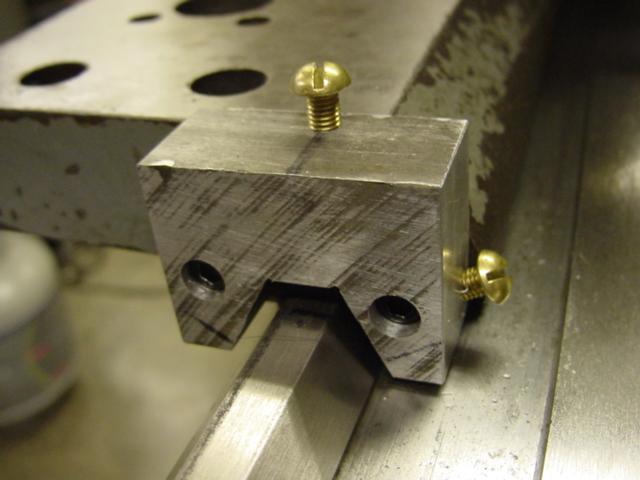

    The saddle is now all milled up and ready for Moglice. I would have done it this afternoon but the pot life is too short when it's warm, and it was over 80 with the cooler going full-bore. I'll have to wait for a cooler morning.
    It did align properly, about .033" gap all around after getting the height above the feedrod being used as the height reference. I need to score the V on the saddle some with a carbide burr (the side milling looks too good), check the alignment with the spindle and set that, then put the oil groove tape, plug the oil lines and I'll be ready.
    One thing, though, if someone out there has a 10EE with very little wear I'd like to get an idea of the clearance between the rear of the bed and the saddle. Mine ended up at .010 but I really had to sort of guess at it a bit. I can fudge it a bit but would need to know now which way.

    The height of the saddle is set by measuring the distance from the top of the apron to the hole the power feed passes through the apron and worm (6.375" if my memory isn't gone), then establishing the same distance from the bollom right corner of the apron to the power feed rod mounted between the gearbox and tail support (quite rigid mounting at the tail). I can get this to .001" or so with a good light by setting up a master on a surface plate and vertical height guage. The idea for using this as the reference came from Daryl and Tim in D and I owe them thanks and a beer.
    Once the height of the right corner is established I can adjust the level of all corners and have the original height of the saddle (minus the grinding, of course) and expect that the vertical alignment of the apron will be correct, so my question relates to the horizontal alignment. My thoughts are:
    1) it doesn't matter too much as I can shift the apron fore and aft a bit on the mounts.
    and
    2) I may as well establish the saddle within a couple of thousadths while I'm getting ready to put the Moglice under it.
    The reference I used for milling was the part of the saddle that overhangs the bed on the rear of the lathe. There's some smallish clearance between the saddle and the rear of the bed that I expect is pretty standard on the 10EE, and matching this would put the bolt holes in the saddle at the 'proper' distance from the front of the lathe and give the other reference for the apron.
    The whole saddle is mounted on jackscrews that are in blocks mounted in the wiper blade holder holes on the saddle. The rear mounts have 1 screw each, the front 3 with one handling elevation and the others bearing on the bed V and controlling horizontal position and the perpendicular alignment of the cross slide to the spindle. Here's an image:

    Well, I checked the alignment between the threading dial and the leadscrew and it seems ok, so I'm going with the setup as I have it. Here it is all glued up:
    I had to wait for a weekend morning to do it as that's the only time I could have the shop cool enough to have a good pot life. As it was it was getting a bit stiff as it went on. I think there's some bronze or something in the Moglice as well, it felt 'gritty' as it went on.
    You can see some oozed out - I used all 100 grams and the calculations I did suggested that 65 grams would be enough. Better too much and some oozing than air pockets after it's set up - there's no fixing holes with this stuff.
    I've shut down the cooler so the shop should get warm enough to cure it today. I'll try to jack it off with the adjustment screws tomorrow night. I just hope it comes off and that I can find my original oil holes...

    There's a spray-on release agent that *should* release it after it's hardened. I sprayed a couple of coats and buffed it lightly. The spray is over a matrix of fine line tape to provide oil grooves for the ways. Here's a slightly out of focus image:
    The Moglice cures like any epoxy so the cure rate is dependent on temperature. The shop is now about 80 degF and the Moglice seems pretty much cured - I could hardly dent it with my thumbnail. Still, I'll give it until tomorrow night to set fully before I tighten the jackscrews and see if it comes loose. If it doesn't I'll put jack it off one of the cross members on the bed.

    In case anyone was wondering the Moglice released just fine. I used the jackscrews - simply tightening them a bit. The front right one felt like it was stripping and gave me a scare, but it turned out to be Moglice on the screw, and turning the rear one down a little bit brake the back loose with a sloght 'pop'. The spare Moglice was cut loose with a Dremel and a 3" fiber reinforced cutting disk, some of the rear needed to be grooved and broken off (dangerous, that) with a small cutting disc.
    The surface came out perfect except for a small spot near the the oil line on the back of the V - I don't think I got enough Moglice there when buttering it up for fear of messing up the wax plug in the oil line. I checked with Devitt and they thought that my plan to plug it with a bit of epoxy (3M 2216, an epoxy that sticks to most anything) just fine. The 1/8" find line tape was just right for the oil grooves, and peeled out with the tip of a razor knife very easily.
    After noticing that the saddle was hard to get moving I gently scraped it to get towards the 60% bearing suggested by Devitt, this to help it get up on oil faster. I'll likely have to do a bit more as it's better. but still not there. I did check the original reason I decided to grind the bed - I put an indicator on the front underside of the bed (where the ball bearing gib runs) and ran the saddle back and forth - about .0003" change in the indicator reading. I'll take a razor knife under there and see if there's still something stuck as it feels dirty, but that's a whole lot better than the .006" or so I saw before.
    I also cleaned out the oil lines and attempted to put in some new copper. That's not going to be a lot of fun - particularly the feed line from the front and the V feed line. Sometime this weekend with much swearing it'll be done, I'm sure.
