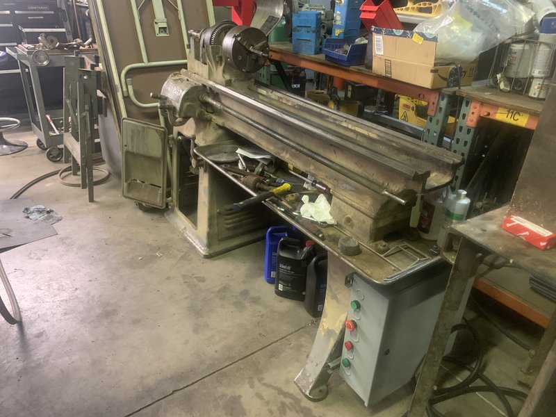

She took a beating!

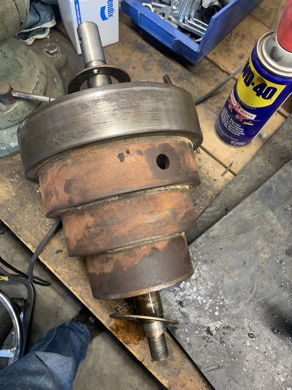

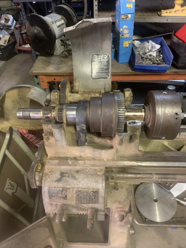

First look at the spindle bearings. Nothing looked overly worn. In trying to remove the chuck, it was discovered that the #9 Woodruff key was sheared on the top cone pulley shaft. I STILL have not figured out how to remove the chuck, and I've tried most everything on Youtube!

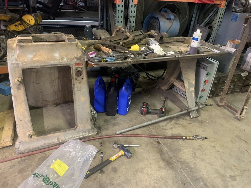

The chip tray doing what it does best... collecting junk! The box mounted on the right side of the foot controls our rotary phase inverter.

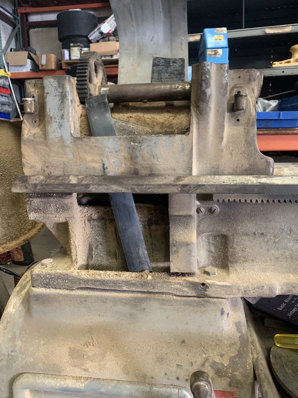

Not too bad on the outside, but boy the inside sure is gummy!
The belt is cut! I tried everything in the world to get the lower pulley out of the belt without cutting it. Three hours wasted, and I ended up cutting the belt anyway.

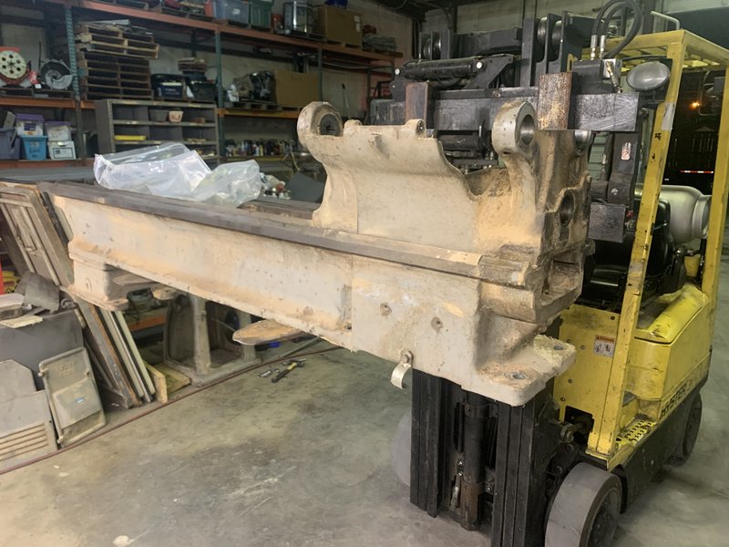

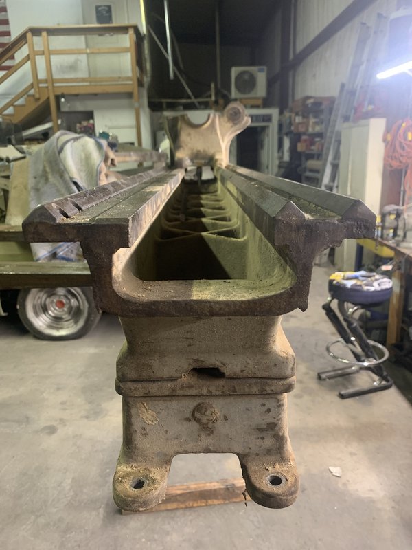

The yellowy color is more sawdust. The ways seem to be in ok condition. I have done no measuring, so I don't know exactly how good/bad everything is.

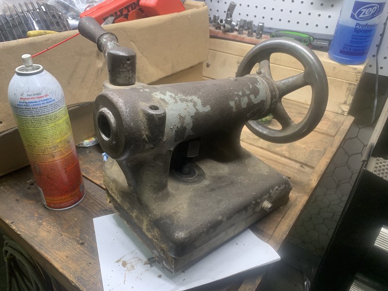

Probably the last thing I'll restore.
Topless! I bought A, B, C and way oil by the gallon From MMC.

If you don't have a forklift and a power washer...GET ONE!

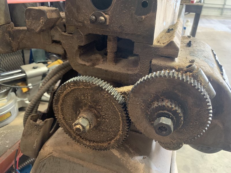

So far, no missing teeth!

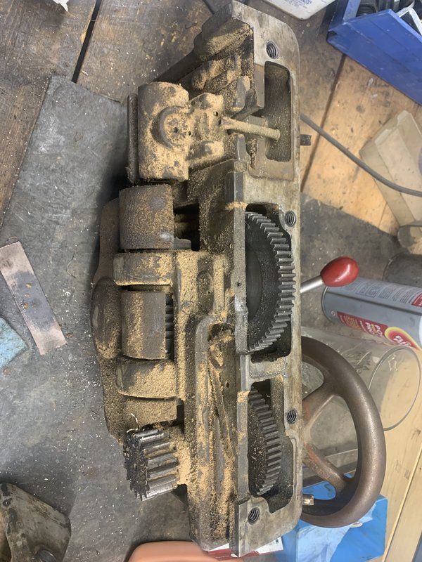

Peeking in the window of the apron. I think about 1oz of oil came out of the drain plug.

Needs a soak!

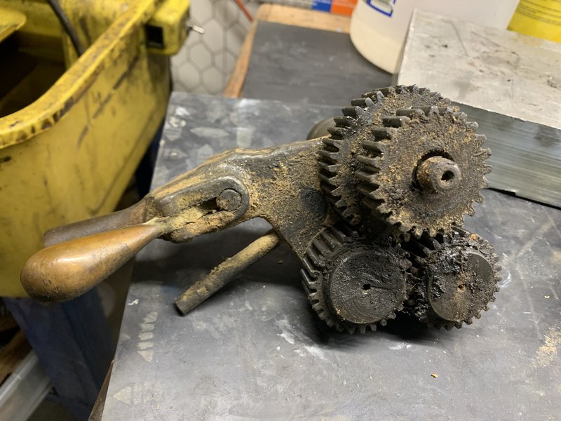

(Your reversing gears not only need a soak, but a complete disassembly!).

possible tip for getting your chuck off. As you already have the spindle out, see if you can press the spindle pulley and bull gear off. Then you can drill and bore (if you have a mill or another lathe) a big chuck of steel to the OD of the middle part of the spindle under the pulley (ie, not a bearing surface). Drill and tap for 4 bolts, then split it down the bore. That'll give you a very rubust shaft clamp to hold the spindle with. Soak the spindle through the bore of the chuck (plug the spindle bore) with kroil/ ATF/ whateverpenetrant for a couple of days. Heat the willies out of the bit of the backplate that threads onto the spindle once a day or so. Then clamp the spindle in a bench vise, put a piece of 1" hex into the chuck and use an impact.*

Broke down the apron today and boy what a mess! The pin that locks in the keyway on the clutch lever was found to be sheared off. That’s the third sheared pin/key I’ve found on this lathe. I’m so glad I tore this thing apart right from the get go, rather than doing the plug-and-play, and trying to figure out why nothing worked properly!

Man that would have been good advice before I put the spindle back in. Once I found the key was sheared under the cone pulley, I replaced it and put it all back together after I painted. I then tried the strap wrench technique, only to break the handle off! Next will be my 1” impact gun with a big hex in the chuck. Fingers crossed!

that's a shame. I'd personally just take the spindle out again :) If you're trying to remove it in place make sure you hold the spindle not the spindle pulley or backgear. It'd be a shame to have to replace another key or the spindle pulley if it cracks at the spindle lock position (only seen that once though). I did see a thread where a guy built a long lever to clamp to the end of his spindle (not sure if it was an SB or a different make). Took a few iterations, but it worked in the end.
